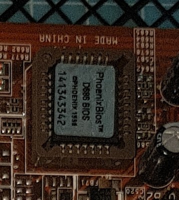

I have a NF7s v2 that sadly doesnt post.. and gives a black screen. I have tried all the discharging tricks, different psus, ram sticks, video cards and different slots of the last two and narrowed it down to it possibly being a corrupted bios. It gives the correct beeps when there is no gpu or memory installed so i think it is getting pretty far into the post until its handing over to the bios. The caps look good with no bulges so I wanna try this first before getting the soldering iron out since Im reading that bios corruption is pretty common on nforce2 boards. First I have some questions if you know the answer to:
1. Has anyone fixed their abit board with a different pheonix bios chip before? Im seeing an old old post on a miscellanous forum that abit might have write protected the bios chip.
2. Are there usb dongles I can put my corupted bios chip in to write to it on a modern computer so i dont have to find another nf7s v2 board thats working
3. Can I get the phoenix bios chip from any nforce2 board, swap it to my board, boot it up and rewrite the correct firmware to it?
Attached is a pic of the bios it has.
    46.34 KiB
    653 views
    phoenix

Do you get any sign of life from the floppy drive, as if you do you may still be able to attempt a 'blind' bootblock recovery flash - something like this https://web.archive.org/web/20150416085038/ht … /bootblock.html

I have revived some boards with a corrupted BIOS that people dumped as "broken". It happens. I don't remember if they were Abit, I don't think so.
You can either flash that same chip, provided you confirm it's not physically damaged (you can read or write without problems) or buy a new one and flash it.
I prefer to use an external flasher like the TL866II or any other you could get your hands on. It's nice, clean, hassle free. Last resort is using another motherboard with the same BIOS socket and once you boot, remove the BIOS, put your empty chip, and flash it. You need to boot using a floppy and use uniflash. Not the friendliest route and not always compatible.
Go on and flash it with the latest BIOS and see if it comes back to life!

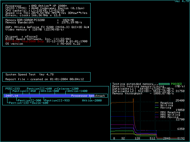

I have this motherboard and was trying it recently. It's tricky. It has a bug of some sort. I thought it was the BIOS but I'm not sure that it was.
The caps looks fine and top-quality.
I tried many BIOS and all show this behavior.
You can enter the BIOS, but it hangs. You need to enter and exit the BIOS pretty quickly, and then just use it. I didn't do extensive testing.
I observed a similar behavior on a A7V8X-MX SE I have. You try to enter the BIOS and it hangs.
I managed to enter the BIOS on the NF7-s 2.0 and modify the options with a Duron 1.4 CPU.
Then I managed to get it booting with an Athlon XP 2600+ AXDA2600DKV4D and an Athlon XP 2800+ AXDA2800DKV4D.
