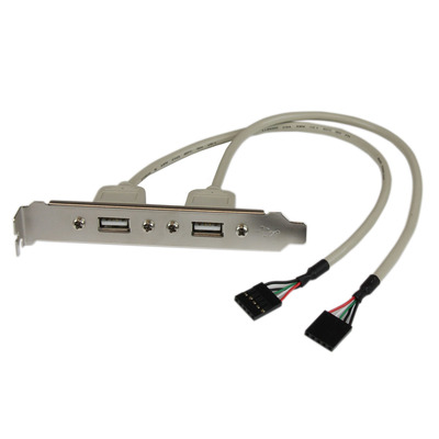

Reply 3 of 7, by Repo Man11
I use these style of USB plates on AT motherboards and adjust them as necessary:

Reply 5 of 7, by Cosmic
Repo Man11 wrote on 2022-04-18, 20:42:
Thanks! That looks like what the board expects me to use, where each port has a separate 5 pin connector.
