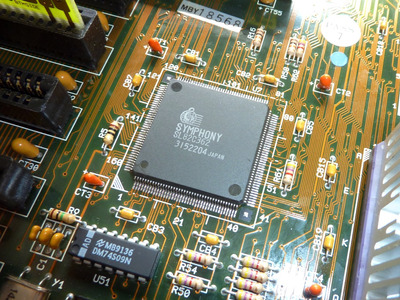

This is the original situation:
376.16 KiB
1547 views

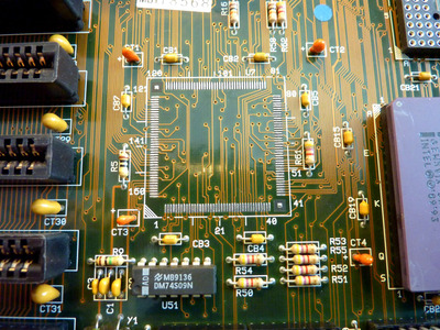

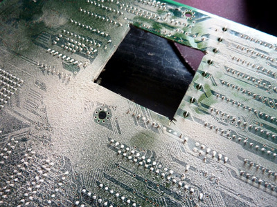

Here´s the mainboard after I did this:
680.73 KiB
1547 views

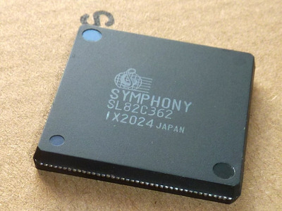

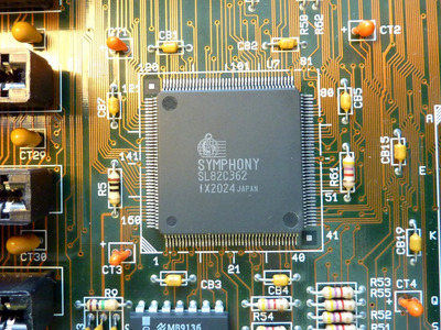

and here´s the old chip:
134.87 KiB
1547 views

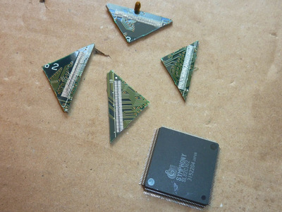

O.k. - yesterday I got hold of the donor-board. The BIOS chip was missing, so I gave it a try with the Symphony BIOS of my FIC 486SC-P. It started, but cache and RAM were not recognized correctly. I was unable to find an original BIOS online and now I knew the donor-chip was working so I decided to start the slaughter.
First I drilled 4 holes from the upside to mark the area to be cut out without damaging any legs of the chip. Then, 4 quick cuts later the chip dropped out:
282.49 KiB
1200 views
Before, I made two diagonal cuts also to split the area in 4 quarters and each row of pins could be easily removed after heating the pins carefully with the hot-air station.
This is what I got:
204.53 KiB
1200 views
There was very little heat needed for a short time only and no leg was bent!

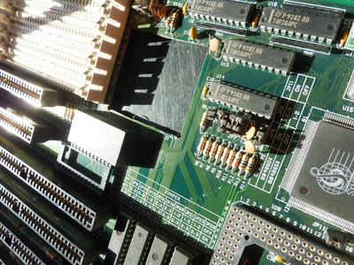

Then all the pins had to be cleaned carefully and I applied a little fresh solder to all pins.
Finally the transplantation could take place and the result is as good as if I had used a new chip:
436.63 KiB
1200 views
So far the system is working flawlessly. But I will have run tests for a while to make sure all issues have been solved.

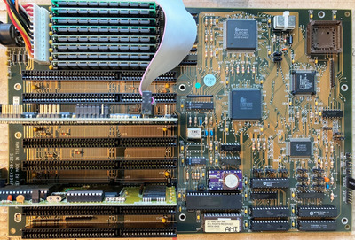

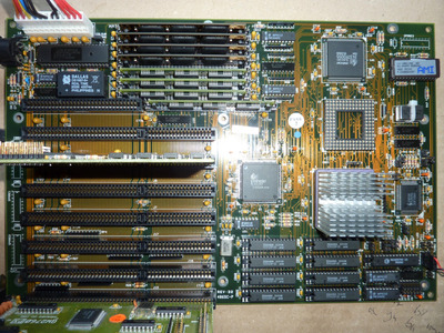

And I think this beauty is worth it:
840.75 KiB
1143 views
