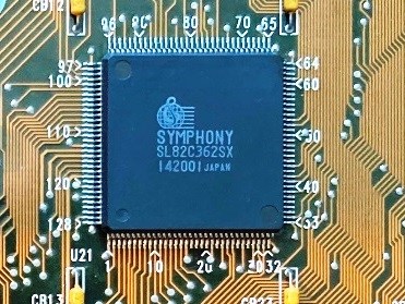

Reply 21 of 26, by majestyk
Good idea, I´ll think about a new (better) title for this topic and edit it.
In the meantime I found that "DMA channel 2" is indeed used for floppy-drives in AT systems, so a dead "DRQ2" input at the 82C362 would explain the failing floppy drive.
Maybe someone shorted pin6 (DRQ2) and pin7 (-12V) when pulling out an ISA card... 🙁
Reply 22 of 26, by majestyk
Yesterday I removed the defective chip and I even found a donor board with a working SL82C362, but then I noticed (right before I started to solder it) that the SL82C362 is QFP 160 while the original SL82C362SX is QFP 128!
46.66 KiB
195 views
Finding one of those could be a tough job, I couldn´t find any other mainboard model based on this chip in my collection so far.
Maybe someone here has any information?
