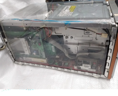

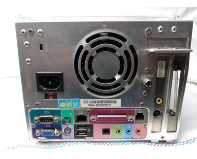

Reply 6 of 25, by Cuttoon
Rikintosh wrote on 2022-05-03, 22:07:
Also, it has its AGP slot occupied by a card that I've never seen in my life, it's a card that only has an RCA and an S-Video output, I think maybe it's some kind of expansion of the onboard video card, but no I'm sure, because I haven't dismantled the machine yet to see it up close.
Would love to see a pic of that card.
Sure it's an AGP? Some of those media-oriented rigs of the time had all kinds of weird stuff in them.
RCA and mini-DIN connectors point to video out, in or both. May well be a mere extension to the onboard graphics. Not TV tuner, those will have a connector for a coaxial antenna cable and usually some metal shielding box. Just google PCI TV card.
CPU: Well, is one in there? That would be a great one, it's already in there. 😜

Reply 9 of 25, by Rikintosh
He still hasn't reached me, I only have these pictures. Watercooler would be out of the question due to lack of space. I don't want to be picky with TDP as I know all P4's get hot, I just want to make sure I install "the best I can". I can't wait to play farcry. I think I have a GF4 around here that will fit him like a glove.
