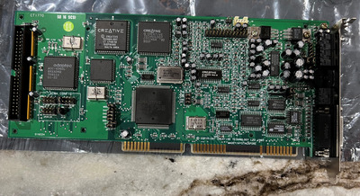

I FINALLY got hold of a compatible 512KB cache module to upgrade my ECS motherboard (which has zero cache), and I'm ready to put this machine together. Actually... I'm stuck trying to find a compatible 32MB SDRAM module for this board but presume 32MB of RAM will be installed.
I am a Pentium II and later guy, so I would like to get your feedback, suggestions, and experience working with a machine of this era and what you would do if you were in my situation wanting to see average framerates of 30fps or better in a resolution of 512x384 for 3D (Yes, I know... get a faster system!) Some older DOS games like Commander Keen would also end up on this system. Thanks in advance for your help!
Here are some considerations:
  • What kind of performance boost can I expect upgrading the cache from 0KB --> 512KB? Was this a worthwhile upgrade at the time?
  • Which video card would you use? See list below of cards I own. I think I have selected the best candidates, but I can look for other options if you suggest a more satisfying alternative.

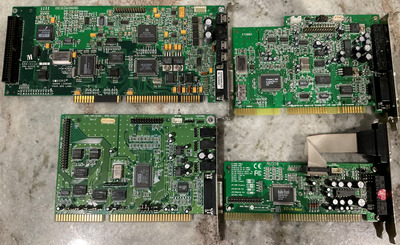

  • Sound Blaster 16 - Please see photo for compatibility issues or benefits I should take note to steer games toward or away from this system). I referenced here before purchase: https://docs.google.com/spreadsheets/d/1o0_u- … #gid=1663779470
  • What games would you play on this system?
  • Does anyone know where I can find a PowerVR version of Virtual-ON????? I only own the MMX and Japanese MediaKite releases 🙁
  • Are there any concerns with having the SCSI CD-ROM hanging off of the Sound Blaster 16 instead of a dedicated HBA (of which I own several I could use)?
  • Should I use a different ISA card / ISA card combination to handle separate duties?
  • Any other input or suggestions?

Sound Cards and Wavetable Available
Sound Blaster 16 CT1770
Sound Blaster AWE32 CT2760 w/32MB (28MB) {I'd like to use this one in a 440LX or BX build}...}
Sound Blaster Vibra 16S CT2860
C-MEDIA AV310 CMI8330A {Planned for a build only someone from Vogons would love...}
Media Vision Pro Audio 3D Spectrum w/SCSI
ESS AudioDrive ES1688F
Dream Blaster S2
Dream Blaster E-Wave
Dream Blaster X2 (Inside the X2 Box)

Sound Blaster 16 CT1770 (DSP 4.05, OPL3)
Media Vision Pro Audio 3D Spectrum w/SCSI (looped into the Sound Blaster 16)
Dream Blaster X2GS (attached to Pro Audio wavetable header)
SCSI CD (hanging off of the SB16)

Having at least 256KB of motherboard cache vastly improves the performance (around 25%) on the Socket 7 platform. From 256KB to 512KB is incremental (around 5%) and depends of the application you are going to use.
For video hardware I would go for the Diamond Stealth 3D 2000 Pro 4MB + Voodoo Graphics combo as it is the most compatible. PowerVR PCX could also be added as a second 3D accelerator if desired for titles that looks best on that hardware.
The SB16 is good except for games that uses single-cycle DMA such as Wolf3D and Jill of the Jungle where you will get a clicking sound for samples larger than 64KB, later DOS games that uses auto-init DMA such as DOOM and Descent are fine. When using the SB16 MPU-401 you should avoid it for games using the Build engine because of MIDI stuttering when using higher sample rates for digitized sound.

Reply 4 of 23, by Gmlb256
Meatball wrote on 2022-05-13, 21:05:
I updated the post with additional ISA options; should I change them up, or I was thinking to use the ProAudio Spectrum for MIDI (and SCSI) duties instead because of your points?
That MediaVision sound card isn't PAS16 compatible but that one can be used for MPU-401 duties. If you can deal with the IRQ and DMA resources you could add a second ISA sound card and connect a cable that goes from the line-out from one sound card into the line-in from the other one.
There are other good alternatives:
  • SB AWE32 CT2760: Has real OPL3 integrated in the CT1747 chipset and said chipset also mitigates the hanging note bug despite having a DSP that suffers from it. It also has the EMU8K chip which on Windows can be used to load SF2 SoundFonts up to 28MB and for MPU-401 emulation with DOS games. On pure DOS (or MS-DOS mode) there is AWEUTIL for the same purpose but it is limited to SBK SoundFonts and compatibility isn't great (at least there is DOS32AWE for protected mode games). There are also some games that are capable of loading custom SoundFonts on AWE cards.
  • ESS 1688F: Has ESFM instead of real OPL3 but it is mostly faithful to it. Can also be used for MPU-401 duties without any problem.
Reply 5 of 23, by Meatball
Gmlb256 wrote on 2022-05-13, 21:44:
That MediaVision sound card isn't PAS16 compatible but that one can be used for MPU-401 duties. If you can deal with the IRQ and […]
Thanks again; Media Vision it is!

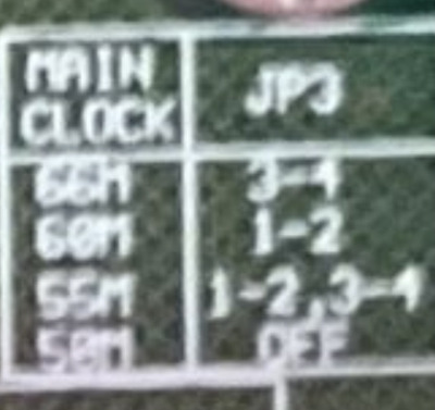

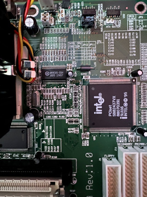

Reply 16 of 23, by Sphere478
Meatball wrote on 2022-05-17, 03:26:
Sphere478 wrote on 2022-05-17, 02:08:
Going from 0kb to 512kb should help a lot.
There is also k6-3+ If you want even more 😀
Not for this board... 200MMX is as fast as it will go... all kinds of roadblocks on this ill-advised purchase...
If you aren’t interested that’s another matter, but I’m looking at your motherboard on ultimate retro and it appears to have dual plane circuitry.
If interested in having me take a closer look send a high res pic of the top left part of the board particularly interested in those jumpers and what it says on that chip by that transistor without a heatsink.
There may be a jumper configuration for 2.0v-2.2v is what I’m suspecting. If so, then there shouldn’t be any hardware roadblocks to installing a k6-3+
Curious what voltage you get with the p55c/p54c jumpers totally removed also.
The outside corner of the processor where they removed one pin to make a notch. That center pin is vcc2 if you put a volt meter between it and black on the psu you can see core voltage with no cpu installed

Reply 17 of 23, by Sphere478
Also if your clock gen is w49c65 it appears to have a 75mhz fsb option, meaning that if you can find 2.0-2.2v setting, your max speed is 450mhz
https://www.datasheetarchive.com/pdf/download … e=P&term=W49C65
Not much that you can do about max ram though. That chipset will probably always be limited to 128mb if I recall. But at least it can be low cas sd ram! :p (can use 128mb with k6 with onboard cache (3, 2+,3+), but stick to 64mb with all other chips)

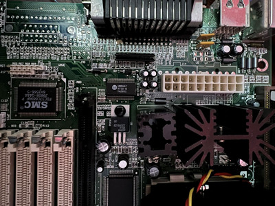

I've attached photos of both "top left" corners, heh.
Reply 19 of 23, by Sphere478
Okay,
Your board supports 2x
So you can set 6x 2x = 6x on k6-3+
The attachment 3CCD8FF0-420A-4E6F-A611-E2DDC91797B3.jpeg is no longer available
That clock gen supports 75mhz
So you MAY be able to set up to 6x75 (450mhz)
They seem to talk about the 55mhz option as a high z option, whatever that is.
The attachment D26A9DB4-F9B6-41A5-AB61-3761D941E82B.jpeg is no longer available
At the very least you can set a pentium mmx to 3.5x75 which is a pretty easy overclock.
I’m trying to figure out your vrm controller. I can’t find a data sheet for it. I think this is the chip for it, but I can’t confirm anything yet. It may be a chip for another function but location suggests it may be the vrm controller
