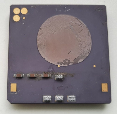

I’m wondering as to the function of the three small gold pads.
These gold pads are for the fan

chrismeyer6 wrote on 2022-06-06, 11:53:
I didn't see your question answered but the 3 gold pads is the power, ground, rpm contacts for the fan just like the POD for socket 3.
I'm talking about the other three. I know the big ones are for the fan, that's obvious 🤣...

Reply 23 of 35, by perhenden
Sphere478 wrote on 2022-06-04, 07:44:
On the socket 3 overdrive they controlled the multiplier in the following way: if fan is working (not shorted?) then 2.5x, else 1x.
Here is a video on that
https://www.youtube.com/watch?v=JVpmTlndEco&a … hannel=Atheatos
Reply 24 of 35, by Sphere478
perhenden wrote on 2022-06-06, 13:09:
On the socket 3 overdrive they controlled the multiplier in the following way: if fan is working (not shorted?) then 2.5x, else […]
oh that's wonderful!
okay wow, so this is all assumption, but I'm gonna guess that that pad is a BF pin... because that would be the easiest thing for intel to do. but that's assuming a whoooole lot.
Question is, what does a 200mmx do when you pull the fan?
It seems like maybe the 200mmx overdrive was more of a package swap, where as the socket 3 pentium overdrive was actually a package and silicon level job.
Edit: nothing happens (according to post screen) when you pull the fan on a 200 mmx OD. The dang thing doesn't seem to make much heat 🤣 they may be running these at less than 2.8v
Edit 2: cpuz also says 200 mhz but man is this overdrive freaking slow...
maybe I'm just spoiled with k6-3+ and dual 233 mmx.
But probably not:
according to cpu-z benchmark I'm like 1/4-1/5th the performance of a 200 mmx right now. So something isn't right.
Edit 3: I plugged the fan back in and performance instantly went up to where it should be. that confirms that even though the bios and cpuz say that it is at 200 it is in fact doing something odd.. perhaps disabling cache? or maybe the core clock is being detected wrong. hard to say...
I wonder if this is what was happening to me earlier. Maybe a dirty contact?

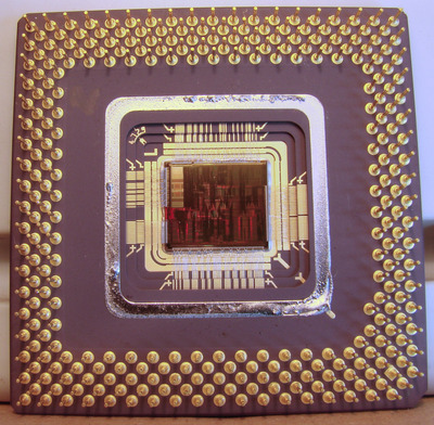

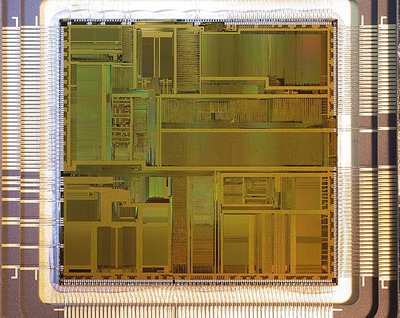

I think if someone decided they were willing to attempt a wire mod they should also de cap a ceramic pentium mmx as well, as I believe it could be used as a guide to figure out which wires were missing/changed.
To be clear if you (people reading this) aren’t aware, these wires are impossibly small, it would require extremely precise equipment and a microscope to do this, if even it is possible.
Unsure what core these pics are of, but appear to be p55 or p54 in a standard non overdrive package.
We should get fritz involved here 😀

If I haven’t mentioned it already, my thoughts are this:
I think intel made this package able to do smp but chose to disable it through gold wire, so I think the traces exist, though I have no evidence of that, it is a hunch.
There in theory should be three pads of interest to us,
One for the smp
And two bf pins.
We will likely see these pads have some or at least one wire in them.
I bet they ran a wire to vss from the smp core pad instead of to the smp pin pad on the package
I suspect the same for whatever configuration sets 3x multiplier.
Setting 3.5x may be as simple as cutting a wire. Or adding one.
The smp core pad, we could re route it to the pin pad on the package or simply move the wire to vcc3 to make it permanently a secondary socket cpu.

Sphere478 wrote on 2022-06-08, 20:30:
Have read your PMs and sorry I don't even have a Pentium MMX Overdrive yet to take pictures of the CPU (have only standard ceramic Pentium MMX).
Reply 31 of 35, by Sphere478
Fritzchens Fritz wrote on 2022-06-19, 17:55:
We could use some high res ceramic mmx shots. If you have better ones than I posted above. That would be helpful. Thanks Fritz!
Oh btw, I see four levels for those gold wires, looks like two for traces, and two for power?
Can you confirm those lower two are power planes?
If you wanna go really crazy, you could map out the pin/pad associations. Specifically the three in question.
Sphere's PCB projects.
