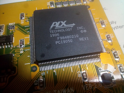

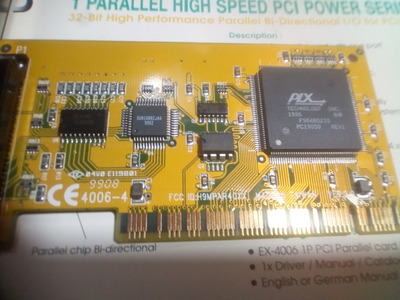

My foolishness continues! This time, I was able to find a cheap LPT PCI card locally. The seller warned me that he lost the CD with the drivers, but I just said «don't worry, I'll find them on the Internet». Yeeeeeeaaaaah...

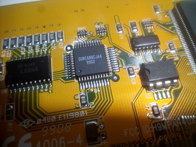

The card is an Exsys EX-4006, with DOS support. The official page offers drivers for the EX-4006A, but it turns out it's a completely different card. The DOS utility doesn't even recognize it, and the XP drivers call for a different vendor and subsystem ID.
The 4006A says: PCI\VEN_1409&DEV_7268&SUBSYS_01011409
My card reports: PCI\VEN_10B5&DEV_9050&SUBSYS_4006D84D
The Archive has a CD with Exsys drivers, but no 4006/4006A in there. FCC ID was no help. I also tried to mod the INF, no dice. Old versions of the Exsys page mention one driver, «PLX-Version_2.3.zip», which seems to be the right one for my card because there is a PLX 9050 chip on it. Sadly, the Archive doesn't have a copy, and Google just throws garbage. Exsys was very kind to answer my e-mails in English (I believe the company is in Germany), but they don't have copies anymore.
My chances are very slim, but if you know something, anything about this card and its driver, please let me know! Maybe there's an FTP server out there...

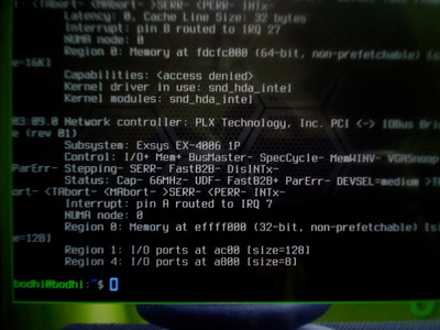

No need, I have a pendrive with a live version of Bodhi Linux, the result of lspci -vv is in the image. What I don't understand is the two addresses. Which one is it? I'd believe it's a800 because of the «size=8» thing...

Reply 16 of 58, by jakethompson1
Ethaniel wrote on 2022-07-26, 21:51:
jakethompson1 wrote on 2022-07-26, 05:27:
Ethaniel wrote on 2022-07-26, 01:58:
DOS would be ideal, XP if possible but not critical. I honestly don't know if the card is offering/presenting/generating the necessary address and IRQ. Is there some sort of reliable «port detection» for DOS? I know there's a version of HWINFO for DOS, but I ignore if it's appropriate for this...
On Linux you would need the output of lspci -vv. I believe there is a DOS port of lspci out there.
In DOS, do DEBUG, then check output of:
i a800
i a801
i a807
and look for an interesting value (we're looking for the parallel port status register)
Probably best to do this without the Covox connected.
