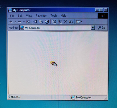

I've been trying to monitor different memory areas that are trackable by System Monitor, and I think I found something consistent. The memory that displays as "Locked non-cache pages" is a resource that always to be consumed but never freed. Maybe it's related?
Reply 18 of 26, by Kahenraz
Interesting! "Locked non-cache pages" will increase when I open multiple instances of programs such as a command.com window or Notepad and go back down when I close them. But if I open a single instance and the close it, the pages will slowly become consumed over time and not free themselves.
Maybe this is the cause of the leak?
Edit:
After further testing, if I continue to push the system and keep opening and closing Notepad, eventually the system will start to reporting that there isn't enough memory even for Win32 applications. It seems that the issue simply breaks DOS functionality much earlier. I can open one Notepad, but there isn't enough memory for a second one, despite there being almost 200MB of available physical memory, and the entire swap file.
At this point, the entire system starts to struggle under its own weight of doing nothing at all. Opening My Computer causes it to hang as it can't get the resources it wants, even though Explorer is already running. It's very bizarre.
