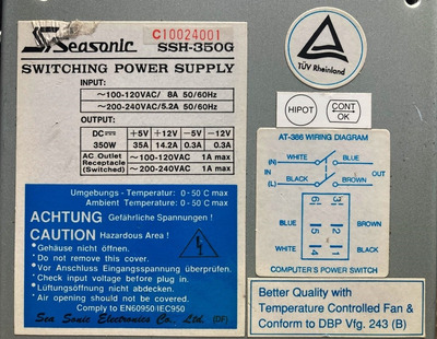

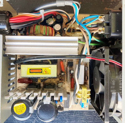

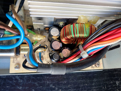

I just cleaned my trusty old 350W Seasonic AT PSU. All electrolytics are Rubycon, no need to replace anything. It just works day in day out.
236.25 KiB
380 views
591.83 KiB
381 views
716.54 KiB
381 views
And it delivers stunning 35A at the 5V rail.
