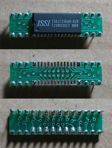

Reply 4 of 32, by ph4nt0m
This is what you're looking for. 2-layer PCB, nothing special except how the pins are soldered. There's some free space left, so I would probably add a 0805 capacitor.

Reply 7 of 32, by pshipkov
Saw these before, but only on a picture. Maybe the same picture.
Not sure how the pins on the bottom that coincide with the pads on the top are soldered. Apparently not using through-hole.
Any insights ?

Reply 8 of 32, by feipoa
I suspect you take a pin header or machine pin, measure out about 2 mm and bend it 90 degrees. Then solder the bent side to the solder pad.
Reply 9 of 32, by ph4nt0m
pshipkov wrote on 2022-08-29, 06:38:
Any insights ?
Break off flat pins of any DIP chip and solder them to the bottom of this PCB.

Reply 11 of 32, by ph4nt0m
Sphere478 wrote on 2022-08-29, 08:36:
ph4nt0m wrote on 2022-08-29, 02:31:
Do we have a gerber for that?
No gerber unfortunately. These were manufactured in the late 1990's. I only have a few units left and that's all.
These adaptors, both DIP-28 and DIP-32, have been in my to-do list for quite a long time. I guess there is enough demand to justify production now.

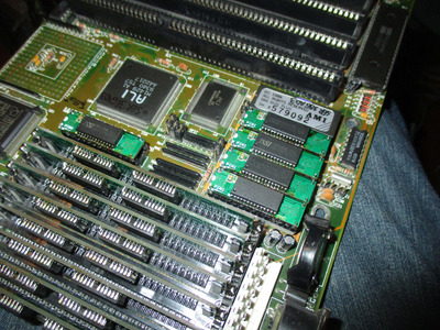

Reply 13 of 32, by Tiido
I made some not so long ago :
1.16 MiB
1134 views
713.55 KiB
1134 views

Reply 17 of 32, by Tiido
Just 2 layers, more is not necessary. The 4 corner pins are for alignment purposes.
Reply 19 of 32, by Tiido
I don't have any at hand and they're all packed away too to show (I'm in the middle of a move to another country) but there's basically just large solder pads underside so that pin headers could be soldered to them, all surface mounted fashion. They're pretty PITA to make that way but I couldn't find a better solution.
