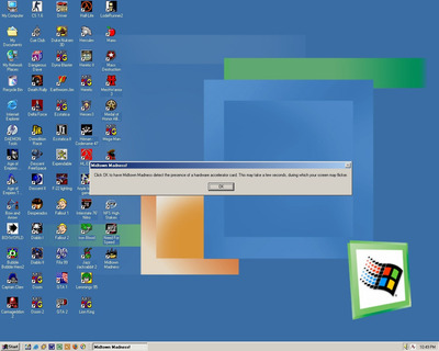

Reply 2 of 24, by alexclaudiu2003
This is the problem with Midtown Madness 1 and redetect video every time I start the game https://www.youtube.com/watch?v=RWXVt9vDCsY
The problem is present with any Nvidia video card and driver version.

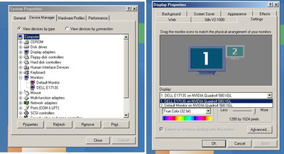

Another question is if I can disable the second monitor, permanently. This is the cause of the problem. I tried from device manager, but no success.
You can modify something in the game with a hex editor, driver or windows?

Reply 4 of 24, by Tiido
You need to disable the secondary video controller instead of monitor.

Reply 7 of 24, by Tiido
alexclaudiu2003 wrote on 2022-11-15, 18:49:
it doesn't work, the cause is from the nvidia video card. I tried a combo of 3dfx with an ATI video card and I have no problem but ATI video card is not good for some games.
So there isn't two nvidia devices in "display adapters" in device manager, just one single nvidia device ?

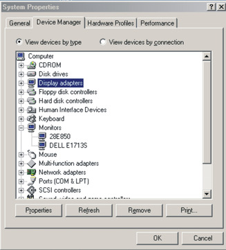

I'm seeing the same thing, curious if it's normal or some kind of error. Deets below.
FX 5950
NV 45.23 - hacked in 5950 and 5500
NVTweak installed
In the device manager I see one adapter and two monitors, Syncmaster and Default Monitor. I assume it's for running dual monitors with the unused video port but not really sure.

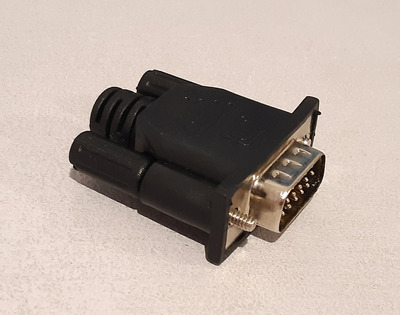

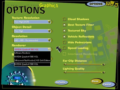

Reply 13 of 24, by alexclaudiu2003
Hello, I tried with an dummy vga adapter in clone mode, but the game does not support cloning mode.
Midtown Mandess 1 support only dual view mode, but in windows 9x dual view mode doesn't not support OpenGl mode 🙁 In dual mode view the Midtown Mandess 1 it works perfectly but but if you open other games in OpenGl, it destroys your settings.

Reply 18 of 24, by alexclaudiu2003
I have only one monitor. Because of this, I bought a fake adapter that emulates another monitor to save the Midtown Madness settings, but by duplicating the monitors, OpenGl games no longer work in windows 9x.
Reply 19 of 24, by ElectroSoldier
Yeah because it wont output to dual monitors. I mean Ive never tried a to mirror one to another, maybe it will work like that. But as its an emulator Im not sure why you would want to as all its really doing is using memory, because it will still need to buffer the frames its just that you have no way to view them, which seems pointless to me.
Im not sure why you would emulate a second monitor at all. But that is what is causing your problems. Remove the emulator and the video card will not register a device on the connector and turn it off and the game will run properly.
