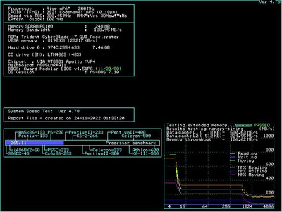

Reply 12 of 15, by jasa1063
I just put together a system with a Rise iDragon (MP6) PR266 @200MHz. I am using a PC Chips M585LMR motherboard. Not a top of the line motherboard, but I got it cheap and it has the very handy CPU Plug-n-Play in the BIOS setup. It makes trying out different speed combinations much easier. Anyway here are the results I got using Speedsys 4.78
    54.35 KiB
    368 views
    Speedsys 4.78 results

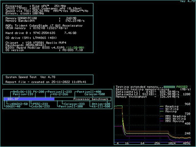

Reply 14 of 15, by jasa1063
I overclocked my iDragon to 250MHz with a 2.5x multiplier and so far it's been stable. I am also attaching the datasheets for the Rise MP6 & iDragon CPUs and Speedsys 4.78 results to compare to my previous post.
    54.21 KiB
    301 views
