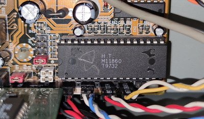

Hi there, I have a question for you all.
I tried to upgrade bios of this nice motherboard, from the 1997 that I have to a 1998 bios to make the machine recognize the K6-2 300MHZ that I would put up swapping from a P133.
I found some nice thread about that motherboard and a set of nice hints about it, comprehending the latest bios working with the AWDFLASH utility there.
So I did a floppy bootable and put the bios and the AWARD FLASH UTILITY there.
When I try to write that new bios it immediately shows me "erase chip fail".
I have no protecting on bios, I just controlled.
I have set the correct jumper to 12v. to flash it, I tried 5v. too but with the same results.
What could it be?
It is perhaps related to EPROM and EEPROM chip? I have an EPROM and it is simply not erasable?
I put a photo of the Award chips.
PS: It's strange cause you can find various people that flashed this bios successfully, and if it is not erasable why I can find newer bios online?

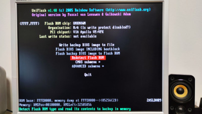

Reply 3 of 57, by biessea
Uniflash says me on the Flash ROM chip: UNKNOWN.
I don't want to have a mess. I have the flash bios image voices greyed out.
What can I do? Try an older Uniflash?

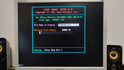

Reply 4 of 57, by biessea
Repo Man11 wrote on 2022-09-25, 13:25:
I would try Uniflash; if nothing else it should report the chip's information. You can also find out more by peeling the sticker back and Googling the part number you'll find underneath.
I do know that the PCChips M507 comes with an EPROM rather than an EEPROM so, on that motherboard, you cannot update the BIOS without replacing the BIOS chip. But my PCChips M520 did come with an EEPROM.
AWDFLASH sees the chip, is a 28F010 /12V
let's see to the image.

Reply 6 of 57, by Repo Man11
I wonder if it isn't actually getting 12 volts when you set the jumper? On my M507 I borrowed a chip out of another motherboard and left the jumper at five volts - Uniflash told me that it was an unknown chip. I then set the jumper to 12 volts and Uniflash was then able to recognize and flash the chip. Another possibility is that the BIOS chip is bad.
Reply 7 of 57, by 80386SX
I advice you to stop to try this kind of thing, especially with a PcChips motherboard (the BIOS chip can be easily corrupted).
And buy a true eeprom programmer (TL866) and a non OTP eeprom chip (AT29C010A, etc.) to make some bios versions tries.
And prog the good version on a OTP chip, like a NM27C010 or W27C010 to fix it.

Reply 11 of 57, by smoke86
Whoa, hold your horses man!
Your motherboard does not support ANY K6-2 CPUs.
It is pretty good chance that you fried your CPU since you did not mention tinkering with voltage - related jumpers.
If motherboard works OK with supported CPU - leave the BIOS alone.
Anyway, that may be OTP chip (one time programmable), and if you try to erase it - it's gone forever.

Reply 15 of 57, by smoke86
Would you mind posting a photo of bottom side of BIOS chip?
No, don't give up just yet. I'd recommend sourcing new blank compatible chip and do this:
1. boot from FDD that contains Uniflash and new BIOS rom.
2. start uniflash
3. remove old bios chip and insert new one
4. program proper BIOS ROM to new chip (remember about setting 5/12v jumper correctly for the new chip!)
5. restart
It should work, if not - you always have old chip that will work.
That motherboard will not recognize K6-2 CPU properly - that information in even included in the guide you posted.
Reply 16 of 57, by biessea
smoke86 wrote on 2022-09-25, 20:35:
Would you mind posting a photo of bottom side of BIOS chip? No, don't give up just yet. I'd recommend sourcing new blank compati […]
2. start uniflash
5. restart
yes I understood, I had simply to buy a chip to program. I will do perphaps, not now. I was thinking I could do this with this one.
I think I can take my P133 overclocked to 166mhz.
That guy that wrote that information and guide, if you search a little, (dosdays.co.uk source) it seems that this board can handle a k6-2 with modified multiplier to more than 400 mhz. Just to say. I was thinking I could done that, only this.
I don't really know what chip to buy now, I'm not that expert. I updated lot of bios before on motherboard and video card, but I never encountered that problem.
Computer lover since 1992.
Love retro-computing, retro-gaming, high-end systems and all about computer-tech.
Love beer, too.
Reply 18 of 57, by biessea
smoke86 wrote on 2022-09-25, 21:29:
I'm not discouraging you to try, just be aware of the risk.
You will need 1Mbit EEPROM chip in DIP32 package, eg. SST27SF010
ok thanks,
perhaps I will buy that chip and try, even if I think for a DOS and Windows 95 computer it's better to stay with my P133 now.
Love beer, too.
Reply 19 of 57, by 80386SX
Regarding the specs : https://www.digchip.com/datasheets/parts/data … 27SF010-pdf.php
If the motherboard have a jumper prog issue somewhere, theorically, you can force the programming mode, by peel the pin32 en plug on external +5.5v.
But really I recommend you to get a TL866 and backup your BIOS before screwing up anything.
It's always sad to have your motherboard that doesn't start anymore, this feeling of bitterness can stay.
