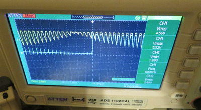

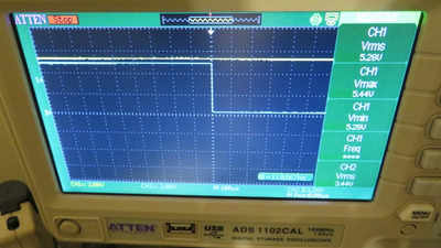

That would have been great if it was as simple as that. But alas...
Patched 0.01 uF caps:
187.52 KiB
873 views
I tried it with first just the cap on power, then added the second on encoder, but the initial transient noise remails:
126.76 KiB
873 views
After about 10 seconds, those transients are gone:
130.43 KiB
873 views
If it was an issue with the transients, then soft-reset should work, but it doesn't. I'll probably have to pull the MB one day.

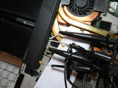

I now have transistors Q81, Q77 and fuse F4 on hand. I have my money on the TPCF8104 MOSFET, which is some weird package. I thought it was SOT-28FL, but the width of this package is 2.3 mm, while the TPCF8104 mosfet on the T61 motherboard is 1.5 mm. I had ordered what I thought would be a suitable replacement, without doing sufficient research. I ordered ECH8315-TL-H, but as noted, its width is 0.8 mm wider. It might fit, but some of the pinouts don't quite match. Drain and gate pins line up, but source does not. So scrub that. There is TPCF8104 on eBay, but the price is not worth it.
Anyway, I will be removing the motherboard soon, however I'm not sure how I will power it outside of the laptop case.
Reply 22 of 34, by feipoa
OK. So I replaced ALL the components (mosfet, bipolars, fuse, cap, resistor) from a spare T61 board, but it did not help with "fan error". Odd. Could it be that BOTH my replacement fans yield this error? I also have a spare T61 board that I tried my fans on, and they show 'fan error' on boot. So it is probably not the MB afterall.
I had recently replaced the fan in my wife's Thinkpad x201 because it was making so noise. I decided to test this noisy Lenovo original fan on my T61. Guess what? No fan error on boot. Bugger! I didn't know the Lenovos were so fussy about which fans they used. I have since ordered two more fans from different manufacturers.

I believe I have resolved this issue now. I don't understand why my replacement fan wasn't working, but I suspect some issue with the wiring or encoder itself. When I bought the same brand of fan for my Lenovo x201 (KFTYR brand), and when the system got hot enough for the fan to turn on, it would always turn on for 2 seconds, off 2 seconds, on 2 seconds, off 2 seconds, etc. Although it would cool the CPU sufficiently enough, it was very annoying to use the computer. I ultimately removed it, greased the original fan, and put it back into the x201. No issue.
I fixed the issue with the Lenovo T61 by putting the old fan unit back in, but I think I found the issue. After time, the wires soldered to the encoder board of the fan get loose. it looked like there was a strand of wire on one of the cables touching either the GND or the adjacent solder point. This would explain why when I blew compressed air into the fan, it would sometimes boot up without a fan error - the air moved the wire strand at just the right moment so that it wasn't shorting another contact.
My conclusion, best to avoid these Lenovo fans with the KFTYR branding. I tried to order a fan recently which looked to be from Lenovo brand in the photo, but the seller send a generic.
Reply 31 of 34, by feipoa
I would expect there to be some protection from current back flow; is that not the case?
At any rate, there was nothing wrong with the fan. Pulling the three wires off and resoldering was all that was needed.
