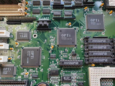

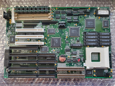

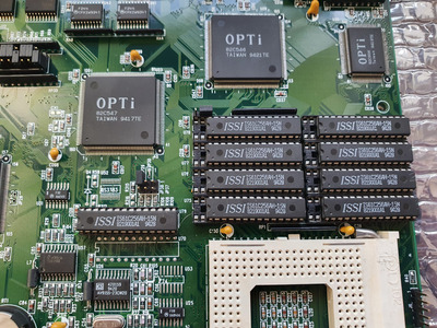

For a long time I'm on a quest to build quite exotic machine Socket 4 VLB. I know that VLB has more sense with 486, but as I mentioned it is going to be exotic build.
I have not found anywhere this exactly motherboards scheme. The closest one (from the same manufacturer and very similar) is here: https://stason.org/TULARC/pc/motherboards/N/N … LEGANCE-PE.html

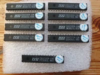

I have proper cache sticks - all tested, not fake etc. Tried it in other motherboard - working fine as 1M.
The problem is cache.
Motherboard does not recognize full 1MB, only 256. And I'm thinking what can I do to enable full 1MB. I'm thinking of placing three missing chips but I have to identify them first. Maybe some bios test from other motherboard?
Anyone have any clue what can I do? Maybe similar problem?
If anyone have similar Socket 4 + VLB + PCI motherboard PLEASE!! contact me.

Reply 2 of 21, by Batyra
Thak you for reply. Yes, of course. I've tried all obvious actions. And even trying two different (also tested) sets of cache sticks.
Reply 4 of 21, by CoffeeOne
Batyra wrote on 2022-10-30, 08:46:
That's weird.
So when you insert the 8 sticks of 128kx8 and close the 2 jumpers the Bios reports 256kb, right?
Is it really 256kB? Did you confirm it with a test program like speedsys?
When you have 256kB working with the 128kx8 sticks, it is very unlikely that the 128kx8 chips are bad. Could be a mainboard or Bios issue I believe.

Reply 6 of 21, by majestyk
kixs wrote on 2022-10-30, 08:56:
I always thought the TAG has to be more then 256KB for 1MB cache. Usually 64K x 8.
This was my first guess also. But the DIL28 socket is limiting TAG size to 256K.
Some (rare) mainboards demanded a different TAG organisation like 16Kx16 (or whatever) instead of 32Kx8. These are sometimes hard to find.

Reply 8 of 21, by CoffeeOne
Disruptor wrote on 2022-10-31, 20:46:
I think that's it. It seems like that board will support 512 kB L2 cache with eight 64K x 8 plus tag with 32K x 8. […]
I think that's it.
In my Shuttle HOT-433 I use eight 128K x 8 plus tag with 64K x 8.
Nope.
Obviously for that Pentium chipset 32Kx8 tag size is enough for 1MB cache. He attached the manual.

Reply 12 of 21, by Batyra
CoffeeOne wrote on 2022-10-30, 08:58:
That's weird. So when you insert the 8 sticks of 128kx8 and close the 2 jumpers the Bios reports 256kb, right? Is it really 256k […]
That's weird.
When you put 1MB and jumpers are set as for 256 it recognizes 256... when jumpers are set to 1M there is "No cache".

Reply 15 of 21, by CoffeeOne
Batyra wrote on 2022-11-04, 11:20:
CoffeeOne wrote on 2022-11-02, 22:28:
Is the 256kB cache working in this case? Confirmed by speedsys?
Yes
Hi, then I assume (to 99%) that your cache chips are good!
So I believe it can only be the jumper settings. I mean it could also be the case that the boards works fine with 256kb, and not correctly with 1MB, but that is unlikely for me.
Reply 16 of 21, by Batyra

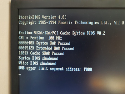

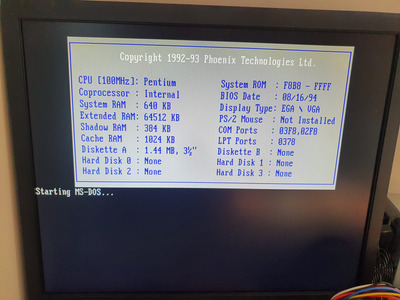

Problem solved!
I've tried different BIOS... it was from exactly (99%) the same motherboard from the same manufacturer and chipset but with socket 5 not socket 4... Revision of bios was the same - I was sure it's identical but after change all started to run!

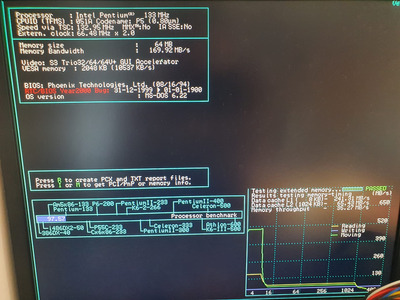

It recognize my 133 overdrive as pentium 100 but it runs like it should... I think I'll ask someone who knows how to deal with micro-codes or how it is called to change it to be named properly!
Meanwhile - thanks to everyone who tried to help!
