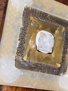

Well I started checking them out, cleaning them and straightening the pins, and I have bad news people. :,(
I’ve made a discovery about these cpus that is going to permanently put testing of them on hold.
When these were made they were made in a quite crappy way with a interposer, a shim and a IHS
The IHS is glued to the shim and the shim is glued to the interposer.
That is sketchy for sure but we all knew that.
What I didn’t know is that it seems like these IHS like to pop off very easily.
Again, not the end of the world.
What honestly shocked me was discovering that under that IHS are goldwires.
Yes, that is how they attached the film chip package to the interposer.
Meaning all these chips that were in computers all over the world owned by all these unqualified people had a high chance of the user at some point having to reapply glue and TIM around those gold wires
I tested several chips, including the 366 and all the 300s I was able to get some life (codes) out of some of the 300/366 chips. But no post screen. Some were just - -
I have a 233 that works. But was unable to find life in the 366 or the 300 chips.
At this point the gold wires need to be inspected under a microscope before I plug any of these in again.
It’s even worse than the fiasco with the super delicate film chip packages from intel/oems
So yeah, I think it is safe to say that these are nothing more than a very fascinating paper weight. I’m not going to be doing any further testing at this time 🙁
I’m sure probably half of them or more are working but it’s not worth the risk to the motherboard to find out at this point IMHO.
Not when genuine intel ppga chips are available. (Sl2z4 sl2z3)

Reply 21 of 55, by Sphere478
One day I think I may take the time to find someone skilled in micro electronics repair and take all these chips apart and inspect all the wires and repair those with damage and perhaps epoxy fill them or something so that they are proper and reliable. But for today I will just be sad that I don’t get to play with the world’s fastest pentium 1 :,(

Reply 22 of 55, by Paadam
On the photo I think I already saw several wires loose from pad.
Gee that solder job is a mess..

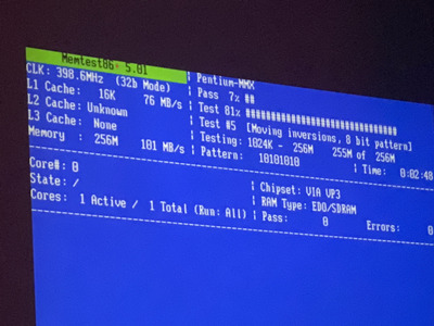

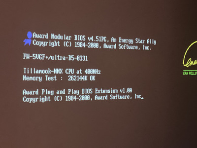

400mhz on a tillamook is just another day at the office, just like 600mhz is another day at the office for a k6-3+570 😀
Tillamooks were held back it seems as a marketing strategy.
The dies themselves are regularly capable of much more.
So this idea of “what they are rated at” doesn’t always have to do with what they are capable of.
The mental disconnect here is that it wasn’t intel that slapped on that label.
The chip can do 366. It isn’t even a issue for them.
    1.42 MiB
    461 views
    1.42 MiB
    461 views

all of my ppga tillamooks will do 400mhz. Probably more, but with only 4x to work with it’s kinda hard to test. Most of my ss7 mobos don’t like higher fsb for one reason or another.
I have two 233 tillamooks and I believe 3 266 tillamooks.
I have many other tillamooks as you can see but the ppga ones are the ones that don’t give problems it seems. (With mods installed)
That second paragraph I believe is the reason that they stopped at 300 with official offerings.
