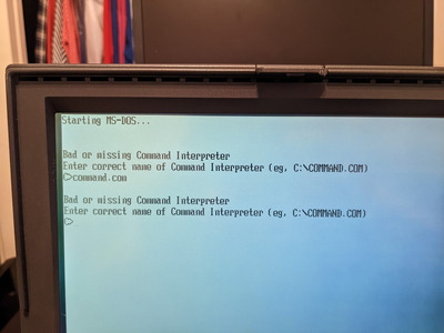

Reply 4 of 17, by EvieSigma
I managed to get the drive to do...something but I'm currently trapped by an issue. The drive apparently has lost track of COMMAND.COM, and if I try booting off a DOS 3.3 floppy to copy COMMAND.COM to the hard disk, the computer can't do it. So I can't boot off the hard drive but I seemingly can't fix it either...is there even a way around this?
149.88 KiB

Reply 5 of 17, by PC Hoarder Patrol
EvieSigma wrote on 2022-11-05, 17:13:
What do the SET PATH & SET COMSPEC variables return at the C> prompt?
Reply 6 of 17, by EvieSigma
PC Hoarder Patrol wrote on 2022-11-05, 18:05:
That's the thing, the C prompt doesn't let me do anything except try and enter the path of COMMAND.COM, I can't figure out how to break out of that.

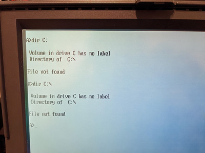

Reply 10 of 17, by Horun
If you boot from floppy can you do a DIR C: or DIR C:\ from the floppy ??
If you cannot then there is something wrong maybe the HD is not set up proper (maybe wrong drive type ?)...
added: if you can do a DIR C: then you should try to SYS C: from the floppy (needs the SYS.COM file)

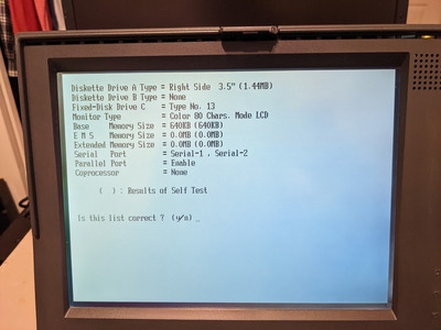

Reply 11 of 17, by EvieSigma
Horun wrote on 2022-11-05, 21:38:
If you boot from floppy can you do a DIR C: or DIR C:\ from the floppy ?? If you cannot then there is something wrong maybe th […]
PC Hoarder Patrol wrote on 2022-11-03, 02:25:
Progress at least...maybe @Horun could add the setup zip to his utilities entry on Vogons Drivers!
Nice find !! I can make a new entry but cannot edit the files in an entry. Will make a new one and point it here for reference....
Can I do a Dir C? That would be a no.
It says Type 13 on the bottom of the laptop so that's what I set the drive as...it's a Miniscribe 8425.
178.68 KiB
289 views
Trying to do a SYS C: gives the message "no room for system on destination disk".
Reply 12 of 17, by Horun
What does FDISK report ? In the MITSU286.ZIP is a FXDFMT.com which is FIXED-DISK PHYSICAL FORMATTER V 2.40
maybe you need to reformat the hard drive with it.

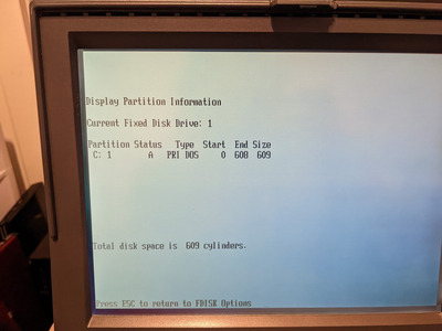

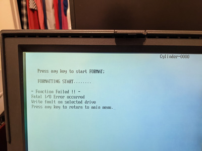

Reply 14 of 17, by EvieSigma
Horun wrote on 2022-11-05, 23:52:
I get this when I run FDISK and view whatever's currently on the hard disk.
143.07 KiB
259 views
When I try to run FXDFMT.com it does try to format the disk but then after a lot of noise it just gives up.
141.46 KiB
259 views
