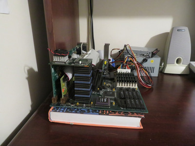

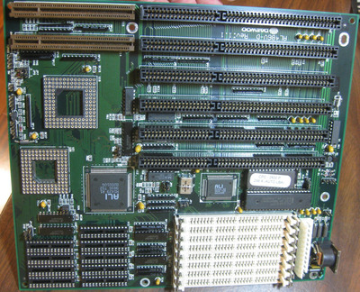

Does anyone possess, know where to obtain, or is willing to create PGA132 rotator sockets? This way, if you go to plug in your 386 upgrade board and there's components in the way, you can rotate it 90, 180, or 270 degrees with this rotator interposer board.

Reply 10 of 116, by feipoa
Sorry, I don't know anybody who owns the Evergreen rotator boards. I don't think an image ever made it to the internet.
All three orientations are equally important because there was no standard placement of the PGA132 on motherboards, nor was there a standard orientation for where pin 1 went.
For one such motherboard I have setup at present, the 180 degree orientation is the one it needs. However, I have run into this issue on a few motherboards.
