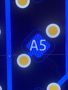

I can probably rephrase. Even with solder mask, I don't like how close the diamond shaped pads are to the adjacent via. They are, what, 100 um?
Since these diamond pads are all merely a direct short to a via next to it, why wouldn't we just solder the PGA pins to those vias and eliminate the diamond pads altogether? If the via is has too small of a surface area to solder the PGA pin to, then why not increase the amount of copper surrounding the via? Or even make the via a PGA through-hole? This is the crux of the misunderstanding.

One via connects to the pad above and one connects to the pad below. You may have already figured this out.
The clearance falls within design rules for the pcb. But for soldering I added the silk above them as a extra measure.
We might find if we removed the silk that these vias are actually burried under the mask quite well. But I suppose that depends on if jlc is having a good day or not 🤣 I think we noticed this on another project, which one , I forget. I think the first sxl2 prototype.

Yes, some vias are burried well, others not. Do you know the distance between the SMD pad and the next via? Relying on silkscreen and surface coating as an insulator seems iffy.
It wouldn't be moving the solder pads, but turning the solder pads into thin through-holes that can accept solder. Was it not possible to make the solder pad and the via the same entity, similar to how the SXL2 prototype was designed with offset through-holes, but the holes on the rotator don't need to be so wide to fit a PGA pin into. We need just enough conductor on the via's surface to solder a PGA pin onto. I'm not sure what to call this, perhaps "thin PGA through-holes"?

Feiopa, you are right. Sorry I didn’t see it sooner. These won’t work. The design rules checker didn’t catch the clearance issue. I assumed because there was no DRC that there was no problem. Let me see what I can do.

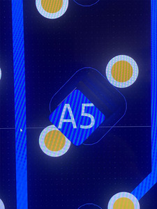

Okay, update: I looked into moving the vias. that was gonna be a mess. so I tried a few things and came up with this:
1.52 MiB
747 views
I have solved the clearance issue by shrinking the diamond pad and the via rings.
Thoughts?

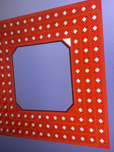

Here is a view looking under the silk
1.85 MiB
738 views
I looked it over again for errors. you might look also yourself. one thing noticed, but not yet corrected is
I will have to make another pass still to correct some more clearance issues that DRC didn't catch. the reason it didn't catch them is because unlike the other projects I didn't bother to give this one nets. At the time it seemed fine that they remain anonymous since everything was 1:1 Which was fine except that it caused this unexpected side effect. I have to enter a property window for each pad one by one for every single pad 264 times and type in the unique pad number and click save to add nets. And then possibly again 264 times for every via.. Now that I know it isn't checking for DRCs on the non netted stuff I can go through and manually check/adjust everything. or go back and add pad nets and let it tell me what to adjust. work, work, and more work.... :'(

Work on the drc fiasco is mostly done. There were only a hand full of actual clearance violations that were revealed by netting everything out. it will probably be 5 hours of work by time it is all back together. the clearace violations it found basically all consisted of 0.2mm allowed 0.1950 actual kind of bs. 🤣 fml.
the real problem was the via to pad clearance which was way too close, and is now long since fixed. I'm basically just making the drc checker happy at this point by filling in the remaining nets. it doesn't appear that any real errors remain at this point.

Okay, the CW 90* version is ready for your perusal.
before I upload it, do you want ground layers? (12 layer) or stick to 6 layer?
I think the best way to do this is with ground layers. but I understand the cost factor.
