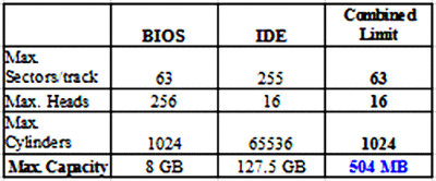

Also, it predated ATA-2 specifications, which is a possible stumbling stone for compatibility (with new HDDs or CF cards).
386 PCs usually didn't even know about IDE, they just used the ancient WD1003 controller language from the mid-1980s.
Which is the same as used by MFM/RLL controller cards.
It's the IDE HDD who has to be able to emulate that WD1003 behavior, essentially.
That's how the classic HDD limit was caused:

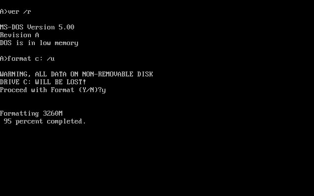

For example: Some older, 286/386 era BIOSes allowed for a higher cylinder count, for example (via int13h). Virtual PC 2004/2007 does, too.
That's why it was possible to make DOS 5 use about 3GB per partition.
2.74 KiB
1197 views
Patch: Re: Browsing a harddisk under DOS without using BIOS routines (INT13H)
However, that BIOS "feature" was latter scrapped for the sake of stability/compatibility.
Newer BIOSes nolonger allow this via the normal int13h, they require the OS to use extended interrupt 13h instead.
So there's a real problem with interoperability.
And there are old DOS utilities that expect that there's a 1024 cylinder limit.
Either because they didn't know any better or for ancient things like diagnostic cylinders.

Because it's not possible for a BIOS to "not have a limit".
The INT13 calls used to read/write sectors use registers to pass parameters. 8 bits for the head (255 max), 10 bits for the cylinder (1023 max) and 6 bits for the sector (63 max). The cylinder and sector are stored together in the same register, there are no "spare" bits.
This is a hard limit, there may also be soft limits (due to the BIOS not supporting large/absolute addressing) that can be worked around with XTIDE/drive overlay software but the hard limit cannot be bypassed without changing the function specification, which would break compatibility with DOS (among other things).

Incorrect. We are talking about the BIOS calls only - the registers are 16 bits wide, not 12, making the hard limit 10+6. Which is exactly what I said.

Maybe, but DOS 5 and its FDISK aren't aware of the extended int13h - merely of the traditional BIOS calls.. That's my point.
"[..] Futhermore, many BIOS manufacturers have added support for INT 13 access to drives with more than 1024 cylinders.
The original INT 13 specification uses a 10-bit cylinder number for a maximum value of
1023 (hex 3FF). [..]"
The technical details are described in the text files supplied in that zip archive.
Please everyone take your time and read it.
The author explicitly wanted the mechanism to be understood, so he did write everything carefully.
The patch works on real hardware, depending on the BIOS, as well with the BIOS used in Virtual PC 2004/2007.
I've used the latter to take the screenshot. ^^
Personally, I believe that's a possible explanation why flynth was able to configure
more than 1024 cylinders without trouble (no boot failure, no data corruption etc).
Even though his unpatched copy of MS-DOS itself perhaps didn't use cylinders past 1023/1024 yet (flynth used a small partition).
