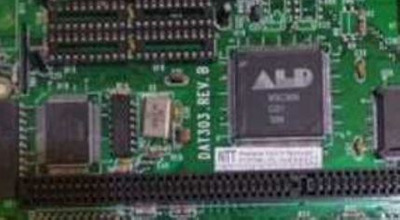

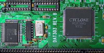

I've been researching ALD chipsets with a few others and came to the conclusion the infamous SARC RC2016 is possibly an ALD relabel (see DAT303), there's photo proof floating around that SARC RC2016 was used on the same PCB with an ALD 93C305.
So, hearing that ALD themselves could be a relabeler sounds interesting.

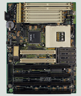

There is at least one other single chip 486 design, from ADC, with a "NEC" marked ADC004 chip (I have my doubts that's a genuine NEC part).
https://theretroweb.com/motherboards/s/adc-adgw2
Unfortunately, this one is even more rare than any of the ALD boards, I don't know of anyone else besides me that has this board, with this chipset.

Do you have a photo of your NEC board?
Reply 9 of 11, by computerguy08
Anonymous Coward wrote on 2022-12-20, 13:17:
Yes, here it is.
Reply 10 of 11, by Anonymous Coward
Interesting. This is quite different than the one I usually see, which had a yellow PCB and looks more like the ALD board.

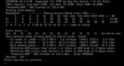

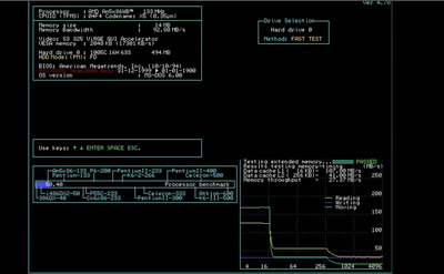

I was finally able to play with this board. It has a ton of settings in BIOS some of which are uncommon and not obvious if they improve performance or not. Found it faster with L2 cache in flow-through than pipeline mode (there is a jumper next to the CPU).
With some tuning I was able almost to match performance of other modern PCI boards, except for a bit slower memory speed and write speeds.
With AMD 5x86 133 MHz, PCI Trio64V+ and EDO RAM I can get 13.9fps in Quake timedemo. Which is close to typical 14.1fps of my SiS496 boards do (MSI-4144 or Asus PVI-486SP3) and a little bit slower than ~14.4fps on UM8886 board (PC Chips M919) or ALI Finalli boards (PC CHIPS 918i or MSI4145). Not too bad. Maybe a further tuning is possible.
The board seems to come with CMA8819(A) clock generator with no datasheet and documented settings for 25/33/40 MHz only. However, the same chip is on my M919 where it is known to have more settings (and one more jumper for extra combinations). So perhaps overclocking is possible (and the pipelined burst cache could show it muscles at 50/60MHz FSB).
