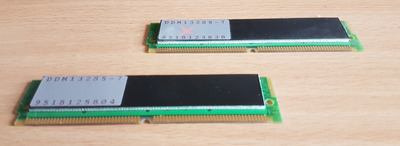

I guess that under extra pcb layer there are chip memories without package and even without globetop.
Is right or other approach?

no markings on the bottom?
Packaging sure fits patent description, maybe you scored trial run/samples of Celetronix DIMMs.

These look like 72p SIMMs though (I counted the pins, just to be sure). Did they trial DIMMs using a SIMM package?
These memory modules look familiar though, I may have seen them before. Following this thread.

oh wow you are right, they only look like DIMMs
You were fooled! 😜 But can happen to the best of us 😜
Anyway, at best at first glance they could look kinda like DDR (SDR has 2 notches and these modules don't), but then the central notch would still look different (the central notch on 72p SIMMs is shallower).
I always count the pins on older modules like these as there were so many different 'standards' around and it's easy to mix them up by assuming it is what it at first glance seems like.
Interesting modules at any rate.

If I absolutely had to gamble, I'd probably wager 4MB 😜

funny how a quick google for Ddm132s5-7, which leads to https://www.afrenterprises.com/manufacturer/v … nology/page-31/
lists it as 'Vlsi Ddm132s5-7 6195 4Mb 72-Pin 70Ns Memory'

Doh, I didn't even try to do a google search. I assumed nothing could be found or why else create a new thread asking questions about it?
But the reason I assumed it was probably 4MB is because I have seen such modules before and they were either the same size, or were 30p which to me indicates these modules had to be very low memory size. Another giveaway is the -7, as only the oldest 72p modules (which are almost always also the lowest memory sizes) would be slower than -6.
I wasn't absolutely sure these modules are 4MB, they could have been 2MB for all I knew.
I'm fairly sure I've seen such modules before, though I'm unsure these were 72p. If I have similar modules, they are probably 30p.
I mean these particular modules are probably not very useful, but still interesting imo.

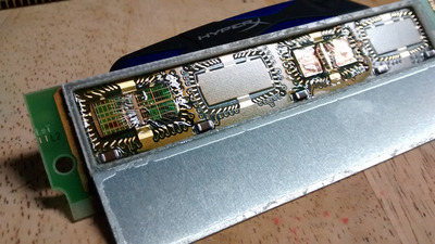

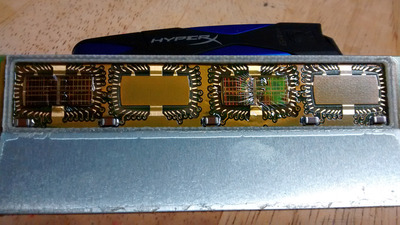

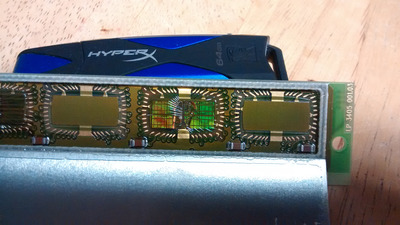

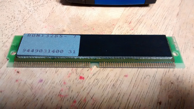

PhatCJ recently posted these on discord

So those arent partials. Someone was saving on packaging costs like 30pin TOPLESS simms.

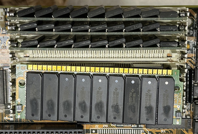

I recently found these on a https://theretroweb.com/motherboards/s/edom-wintech-mv008
532.19 KiB
824 views
The chips are shingled.
There's a sticker on the back saying they are guaranteed to by 60ns simms, but it looks like someone burned the end of the TMS44100 chips to keep anyone from verifying that.
