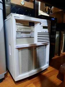

I recently became the owner of a dual pentium III system. I wanted to have one since early 2000.
And now, to be honest, I can't find a real use for it.
