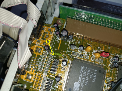

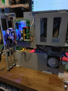

Looking at what could be wrong with the keyboard interface and started taking a closer look around the port.
There's what appears to be a typical keyboard / PS2 fuse near the AT keyboard port (FS1), which seems to be directly connected to the solder point I have highlighted (at least when measured with resistance I get a measly 0.1 ohm between those two points. Interestingly, you can also see there are solder points for a standard PS/2 keyboard header below the AT keyboard port....
However if I measure resistance across the fuse, my multimeter (admittedly an ancient Fluke 73 of about 30 years old) instead of giving me either a steady/fixed resistance reading or an open-loop result, starts measuring at 10M Ohms and increasing until it goes off-scale at 30M Ohms. I do wonder if this fuse has failed in some way that it has not gone open-circuit, but is otherwise limiting current to the keyboard port, leading to the weird behaviour I have observed (the key repeat issues and the Dell keyboard not even powering on).
Simplest test will be to bypass the fuse with a wire link, I guess.

Reply 21 of 41, by megatron-uk
I wouldn't have thought a fuse could do this, but.....
184.21 KiB
519 views
The Dell PS/2 keyboard now powers up!
Even better...
https://youtube.com/shorts/9GHAhATI0YU
No more dropped keys when typing fast! And key repeat is working as you would expect it (hold a key and it repeats indefinitely, not the one-finger-one-keypress-one-character mode it was in).
What type of failure is that from a fuse? I've never seen anything like it - my experience is that fuses are either failed... or they're not. This one was clearly in some failure state where it was passing electrical current (remember I measure +4.94 on the AT keyboard pin), but had incredibly high resistance... that's just bizarre.
I've just cut the fuse and replaced it with a wire jumper for now, but I'll aim to get a replacement fuse fitted asap.

Reply 22 of 41, by snufkin
megatron-uk wrote on 2023-01-07, 10:21:
Capacitative charging? Is that fuse on the Ground side? Might explain why there was still 5V on the pin.
Reply 24 of 41, by snufkin
So, the keyboard has a good +5 supply, but no good Ground? And I think clock and data lines both have pull-ups on them. So the only time the keyboard would see a ground on any pin would be when the motherboard tried to send a status byte to the keyboard and pulled clock and data low. Doesn't sound like that'd work well enough to send any bytes. Maybe someone's used a resistor//capacitor to separate shield ground and keyboard/digital ground at low frequencies (people do strange things with shields), and the keyboard is using the shield as its digital ground?

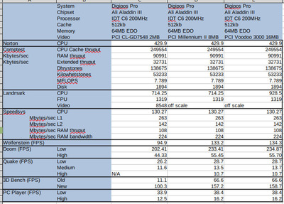

Reply 25 of 41, by megatron-uk
Completed a full suite of benchmarks with this thing:
165.72 KiB
474 views
Looking at Phils VGA card benchmark spreadsheet, the scores are about par for the course for the WInchip C6 200; around the same level of performance as a non-MMX Pentium 133-166. So performance-wise these are not a great chip. The chipset/motherboard doesn't appear to be making things any worse than the C6 alone would perform though.
One disappointment is the disk performance. 1.8MBytes/sec is a fairly poor showing and the level of performance I would expect if the XT-IDE bios wasn't being shadowed... but it is. I don't know much about the ALI chipset and whether the IDE controller is connected to the PCI bus, or on ISA. If the latter, then it may benefit from the stock ISA clock being increased (left at the bios default of 7.14MHz now, since I only have a sound card in an ISA slot).
It will be interesting to see if things get any more sprightly with a P200 and then a P200 MMX.... if the cooling and power supply of this thing hold up.

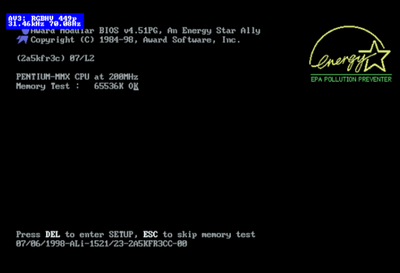

Reply 35 of 41, by megatron-uk
Hmm... think I may have killed it!
Took the processor back out and started measuring voltages on the socket. With 2.8v / dual voltage settings jumpered, I can indeed get 2.8v on VCC2 pins.... but wherever I measure VCC3, it only shows 0.9v.
Jumpered back for the Winchip (single voltage, 3.52v) both VCC2 and VCC3 are back to both measuring 3.53something volts. But, the system still won't power up with the Winchip back in its socket (which is not a ZIF or a LIF, it's some weird slide-the-processor-in-slightly sideways design, and it's the two screws of the heatsink/heatpipe that physically hold the processor in place).
I am wondering if jumpering for dual voltage and powering it like that has pushed some ~25 year old component over the edge.
https://www.target-earth.net
Reply 36 of 41, by megatron-uk
Okay, it is working; both in single and split-voltage modes - the issue is the processor socket itself.
What I've realised is that because of the space constraints of this motherboard and chassis, what they've done is use the base part of a ZIF socket, and then altered it so that the upper section that normal moves to lock the processor in via the lacking arm is no longer part of the socket - just the bare 'U shaped' receiving pins that are normally hidden from view. You instead have to drop the processor into the holes (which are pretty much free-floating - there's almost no contact between cpu pins and the receptacles in the socket) and then insert a small flat-bladed screwdriver into a special wedge-shaped cut-out at the side of the socket, where the heatsink retention clip would normally be.
That pushes the processor sideways into the receiving pins, just as the usual locking arm would. It feels a bit disconcerting to do it by hand, but it works.
Anyway.... the original Winchip 200 works as normal... and the P200 MMX....
183.12 KiB
298 views
Running through benchmarks and it does seem quite a bit quicker (almost an extra 20fps in Doom high detail for ~78fps, and just under 20fps more in Quake 320x200 for ~48fps)...
But.... I'm also getting a couple of random resets/power-offs which didn't happen previously, as well as the CF card not getting detected in between reboots. I think the split-voltage mode and the extra draw of the P200MMX may be just on the limit of what the tiny PicoPSU can deal with, as if I watch the ATX breakout board closely, the power indicator on it flickers just before I get a reboot.
I've got 2x 32MB EDO modules, a 10/100 PCI NIC, 4MB PCI Virge and an ISA ESS1868F in this system now - so it might be worth pulling the cards out to see if it settles down, if so than a bigger PSU would probably resolve it.
