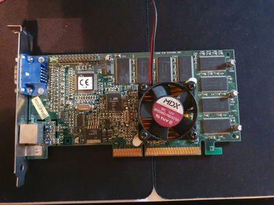

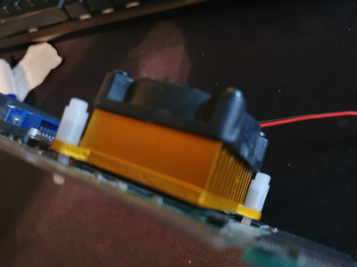

Reply 37 of 46, by Boohyaka
Here's my take on the Voodoo3 3000 AGP ghetto cooling.
Works well, there's a few millimeters difference with the holes so the plastic pins are a bit skewed, but that's absolutely no problem, it's strong and snug.
234.15 KiB
223 views
97.13 KiB
223 views
