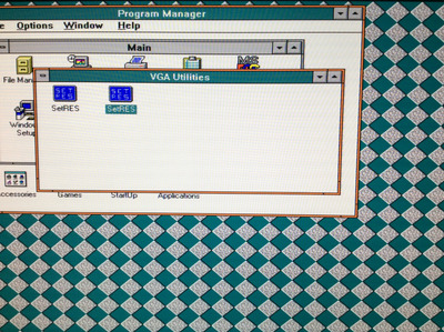

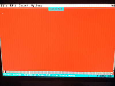

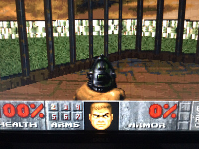

Reply 44 of 68, by drosse1meyer
kaputnik wrote on 2023-01-16, 11:22:
Interesting discussion on jailbars with Cirrus cards. […]
Got an ISA CL-GD5429 graphics adapter in my 486, connected to a 19" LCD monitor. Haven't seen the slightest trace of any jailbars so far. Running Windows 3.11 in 800x600, 65356 colors.
Launched and checked edit.com as suggested earlier in the thread, nothing there either.
The only artifacts I can see is some very slight ghosting and fuzziness, but guess that's to be expected with a 2 meter KVM cable, a KVM switch, and another 30 cm VGA cable between the computer and the monitor. Really got to try to get hold of the shorter 1 meter alternative at some point on that note.
Are there any other suggestions on how to provoke those jailbars? 😀
Yes, certainly, here are some examples from a 5429 VLB. All but the noted exception are through the Extron, for comparison.
You can see how much worse it is when I use VGA output direct to the LCD (some older dell ultrasharp) in the second doom screenshot.
Also, Windows looks perfectly fine. Guess its either because of the display mode and/or driver
    972.16 KiB
    1112 views
    Scaler
    1.17 MiB
    1112 views
    Scaler
    859.83 KiB
    1112 views
    Doom2 - direct VGA
    621.23 KiB
    1112 views

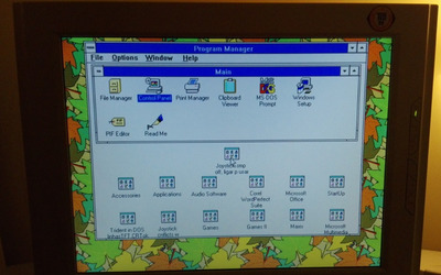

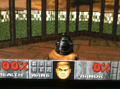

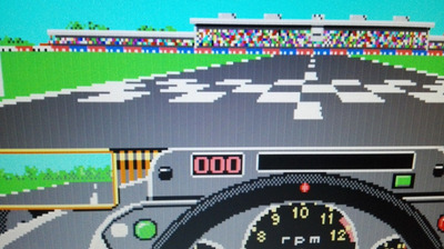

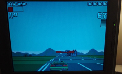

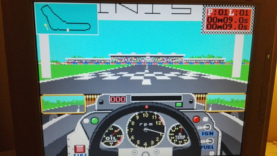

Reply 45 of 68, by andre_6
So here are some examples with my Samsung Syncmaster 151s LCD and Trident 8900CL combo, playing Accolade's Grand Prix Circuit and Lotus III. Less noticeable on camera in Lotus' case but in reality is just as present.
As with other people's examples, Windows 3.1's image is clean as a whistle. Is it due to drivers? Would actually using DOS display drivers alleviate / eliminate this issue?
Reply 46 of 68, by Jo22
3.1 looks good to me, not pixelated. Is Windows 3.1 using the Standard VGA driver?
The Trident 8900 is supported by both the Windows 3.1 Super VGA driver (800x600 16c), as well as by the WfW 3.11 SVGA drivers (256c), by the way.

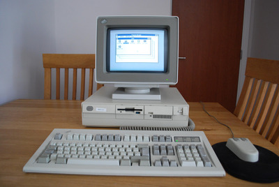

Back in the 90s, I had got a blurry little IBM PS/2 monitor.
And tell you what? I miss it nowadays, exactly because it was slightly blurry. 😢
Windows 3.1 and games looked much nicer to me that way.
Edit: Found a picture for comparison.
That's how Windows 3.x and OS/2 are supposed to look, in my humble opinion.
No scarlines, no pixel-perfectness. Just an ordinary VGA monitor from the late 80s.
    634.53 KiB
    1035 views
    Source: https://www.reddit.com/r/retrobattlestations/comments/gfsp0s/my_ibm_ps2_55sx_originally_purchased_30_years_ago/

Reply 53 of 68, by Jo22
andre_6 wrote on 2023-01-21, 02:00:
For Windows 3.1 I think I'm using actual Trident drivers. I never noticed a single second of jailbars in Windows 3.1, it was always in DOS games. As for DOS drivers as people told me it didn't require drivers and in fact it would be better not to install any I didn't do anything. Jailbars on my LCD is the only issue for me, don't have any more complaints regarding image quality. The LCD is actually pretty sharp and vibrant in person, even though it's clear it had some usage. My phone's camera not that great but at least I think the jailbar effect was illustrated. Thank you for your help and links, I'll compile various driver files and see what's what, even if I alleviated the jailbars slightly just by installing DOS drivers it would be a huge success.
Hello Andre, please don't despair. It may take a while, but I'm sure a solution will materialize, eventually.
There are several things that can be tried out:
- Use an VGA to HDMI converter -> it has its own Analog to Digital converters (ADC, A/D converter).
While they are not as flexible as PC monitors, they perhaps can handle certain signals better.
- Try fixing the noise floor. Either by using a clean PSU or by installing blocking capacitors.
On the mainboared (if there are empty solder pads) or on the VGA cards.
You can install multiple types in parallel (1 nF, 100 nF, 1 micro Farad), if you wish.
An old oscillograph can help checking for noise (RF, ripple etc). Bandwidth doesn't matter. An 1 MHz scope works, as does an 30/50/500.. MHz model.
- Try changing the timings. A DOS utility, like 67Hz.com, can alter things slightly.
