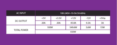

My corsair RM550X died and I have to replace it for my 486, it's being used with an adapter that has a 5 watt resistor on (from memory) the 3.3 volts but I'm not sure if all the new ATX power supplies are good for a 486 when it comes to watts on each rail for example would the Cooler Master MWE GOLD 550 V2 be good I've heard not to throw a high 800 watt psu at a 486 hence the lowish cooler master 550

As far as power requirements go, 350W should be plenty for a 486 system imho.

A typical AT power supply for a 486 has the following specs:
+5V 20A
-5V 0.5A
+12V 8A
-12V 0.5V.
As far as I know -5V are used only by some very old cards, so you have to compare only the other 3. I believe 0.3Amps on the -12V should be fine, too.
Most important for a 486 is the +5volts line, 3.3V is not needed at all.

Basically every atx PSU will do. There are not many 486s that burn away more than 80W. That's the 12v line included. So everything above 200W should have a 15+ amps on the+5v line and that's fine. Just make sure you've got a good PSU: some crappy stuff will not regulate the +5v line very well without a serious +12v load.

Coffeeone the amps from an old psu on all rails should be exceeded by a new psu I am not sure if new psu's have the same or better watts per rail for example the +5 on the cooler Master has a shared +5 and +3.3 of 100 watts and the -12 of 3.6 watts, sorry I don't know much about watts or mathematical formula's to get watts from amps
