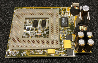

At some point in the future I'm going to try and get some adapters going for the Pentium pro/II/II sockets/slots lineup this socket 8 to 370 interposer will be another of the planned flavors see my pcb projects for the others. until that time, I will use this thread as a information and link dump to help me refresh myself more quickly when the time comes to begin. Any suggestions/requests/ interest do please post here.

Reply 1 of 21, by Necrodude
Awesome!
Im posting a few wayback machine links from the actual old adapter from powerleap
https://web.archive.org/web/20000815203513fw_ … om/PL-ProII.pdf
And tool from powerleap to enable the second cpu when using their product
https://web.archive.org/web/20001109164200/ht … p.com/PL-ProII/

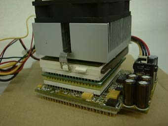

Reply 7 of 21, by imi
your first post didn't quite make it clear if you already have one, so just letting you know I do in case you need any specific detail, I might not be quick with replies but I'll get to it eventually I hope.
504.74 KiB
780 views
Reply 8 of 21, by Sphere478
imi wrote on 2023-01-18, 00:17:
I do not currently own one and due to the rarity there’s a decent chance that I may never be able to get a hold of one unless I make one. So, Yes! Any kind of reverse engineering or details you can give about how you think it is constructed and wired will be very informative.
