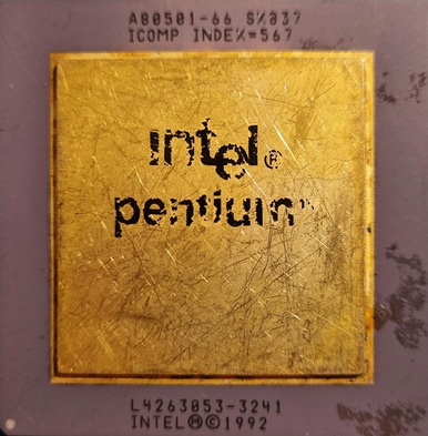

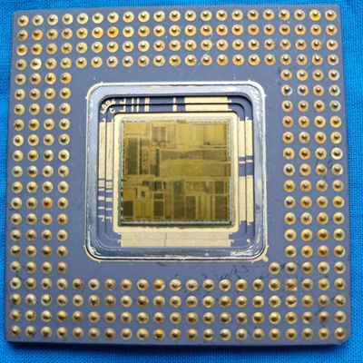

Note: The attached picture is a Pentium 66 processor based on SX837 core stepping, which has the infamous FDIV Pentium bug, I have destroyed it a long time ago being useless for me! [Opened back cover and removed all pins.]
