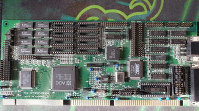

Hy
I find a KG8VL9033A Vesa Local Bus Multi I/O + IDE + WD Video card.
Sadly BIOS chip is missing, and a part of memory too.
I need to indo with jumpers, and what type of bios chips can i replacement, and with what equipment can i burn a bios
And what type of memory ic can i expand the free places.
I need to save this card, because i don't have any vlb multi i/o + video card.
Thanks for any help 😀
Reply 1 of 6, by zyga64
I'd try BIOS image from here: https://www.vgamuseum.info/index.php/cpu/item … ital-wd90c33-zz
As a BIOS replacement chip - Winbond W27C256 should be sufficient. As an eprom programmer I recommend the TL866 (or anything else that is within your reach. Willem programmer - if you have computer with LPT port).

Reply 2 of 6, by mkarcher
