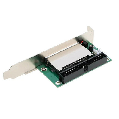

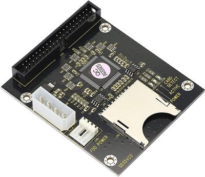

So I went ahead with the cf card->sd project on my pentium 4 machine.
I had some issues with the following chain: SD->SD adapter->Cf adapter->Cf to ide (the one you screw on the backpanel). The bios was hanging after some reboots, I tried several cables since I was initially using a 80 pin eide cable, switched back to a 40 eide cable but the issue was still there. I switched the Micro SD adapter from an apacher one to a samsung but I also did switched from this adapter:
The attachment 001.jpg is no longer available
To this adapter:
The attachment 002.jpg is no longer available
You know less stuff you have, less stuff can give issues. I partitioned the microsd as following:
Win98 partition in fat32
WinXP partition in NTFS
Data partition in fat32.
Windows xp works fine, while windows 98 is a disaster since the boot, windows 98 scandisk complain about lba (which is active in bios), I tried to install windows 98 from the original cd-rom and during the installation a "like" bios screen complained about a sever disk error.
For compatibility purpose I used pio mode 3, lba mode and 32 bit access enabled (in the bios). Unlucky the bios doesn't have the udma disable mode (or is it the 32 bit access?), I also disabled the block mode (which gave me issues in another machine with a cf card).
When I try to boot on windows 98 (dos 7.10) it says: Unable to find the sector during read on unit c.
Also when I boot on windows98\dos7 the other fat32 partition is not visible (data fat32) why is that?

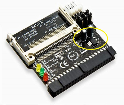

Reply 31 of 53, by douglar
I am not surprised that your SD->SD adapter-> Cf bridge->Cf to ide stack had issues.
The CF->IDE adapter that you show does not look like it has a voltage regulator on it. It can only provide 5V power.
My experience has been that Type 1 SD->CF bridges require a CF->IDE adapter that can provide 3.3V.
Here is an example of a CF->IDE adapter that has a voltage regulator. The voltage regulator is circled.
The attachment 61FLaf0RqRL._AC_SX679_.jpg is no longer available
As for the Win98 problems, how big is your SD? Is it larger than 132GB?
The scandisk errors suggest that the drive is using LBA-48 and Win98 only supported LBA-28 out of the box.
There was a win9x LBA-48 patch developed in 2006 that is floating around.
https://msfn.org/board/topic/78592-enable48bi … -137gb-barrier/
