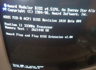

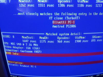

Hi, im making some kind of "definitive" DOS machine, and in my testings i finally found the "perfect" CPU bus/speed
My board is a asus p2e-b, i love this board because is baby AT, have atx connector, 83mhz bus, PS/2 mouse, and the bios is easy to mod to accept 120GB HDD. Baby AT is a must for me in a retro machine
Finally after many test, i found that a Pentium 2 400, with 83mhz bus, running at 333mhz, and a maximum throttle is close to XT speed

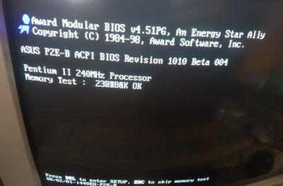

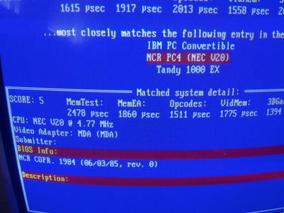

Then to my surprise, if i set a 60mhz bus, the CPU running at 240mhz... and max throttle... i get... exactly XT speed. Is amazing, i tested some 4.77mhz sensitive games, and all work perfect
