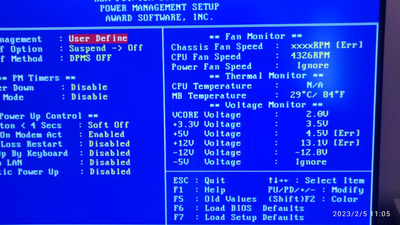

Also below is the power management screen in BIOS . There are indeed differences. +5V rail shows as +4.5 and +12V rail shows as +13.1V:
124.38 KiB
896 views
The chassis fan error is obvious. However, the other 2 are worrying. Any thoughts?

Measure 5V on the motherboard, ATX connector might have bad conductivity. I had few cases of melty charred ATX pins over the years.
Reply 11 of 17, by weedeewee
rasz_pl wrote on 2023-02-05, 09:26:
THIS !
I've been bitten by this myself. measuring the voltage on the connector and everything checks out.
Measuring the voltage on the mainboard and suddenly it is way too low.
All due to corrosion or wear on the connector causing a bad contact with a higher resistance, causing a voltage drop.
Do not ask Why !

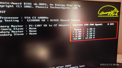

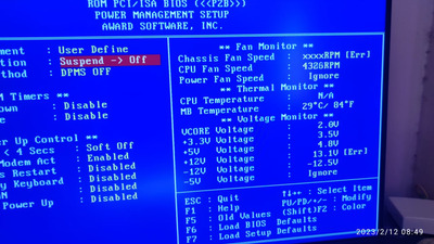

Got a new higher quality PSU (Ant Esports 400W) and measured the voltages. This time the +5V volts measured as 4.8V and +12V measured in the range of 12.9-13.1 V. The power management screen shows an error as soon as the voltage gets to 13V.
122.47 KiB
745 views
Then measured the voltages on a different board (M6VLR) using the new PSU. Interestingly, the +12V read between 12.84 - 12.96 V and the +5V read +5.1V.
74.68 KiB
745 views
So, I am thinking whether it is an issue with the PSU as the +12V measured more or less similar to the earlier one.
