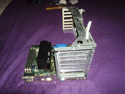

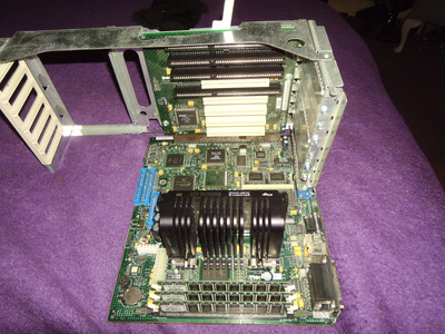

This was given to me recently...and I have no idea what case it would fit in..
presumably proprietory...as both the slot 1 motherboard (fitted with a P2 cpu) and the riser on which all the expansion slots are mounted ...are labelled DELL 1997 RevA1..
Sadly there was no case or PSU which might also be proprietory...and I doubt I would ever find one..
..and certainly not if I can't identify it to search.
Anyone ?

Reply 1 of 8, by iraito
I actually got an NLX format MB from the giveaway thread too https://www.computerhope.com/jargon/n/nlx.htm
It's rather old one, you can still find cases online but i will soon scan my own motherboard and design a case for it that can be 3d printed.
Then again yours looks a bit different from the usual ones, hopefully a generic NLX will suffice and you can just use an ATX psu but it could also be a hellish OEM custom NLX.

Reply 6 of 8, by dionb
Pretty sure this isn't NLX. In NLX systems, the edge connector is on the side of the motherboard and the riser has the 'slot' that plugs into it. Here the (PISA-like) connector is on the top of the motherboard and the edge connector is on the riser. So this is a totally proprietary combination of an NLX-like backplate with an LPX-like riser. It - and the motherboard - remind me of an early Dell Optiplex GX-series system.
Just looking at the shape, this would be from a bulky system, as it is very tall vertically. I find the same risers googling Optiplex GX110, but images of GX110 show a smaller desktop form factor. In any event it will be something close to that.
Edit: gotcha - Optiplex GX110 tower:
images?q=tbn:ANd9GcQkV3p4NBfMFfCFN1EV01WhDXMuH9IXwZg_ZQ&usqp=CAU
Reply 7 of 8, by pentiumspeed
Update: GX1 is slot 1 which your stuff is, GX110 is socket 370 so not that one.
Found it, another one
Dell GX1 full tower. What it looks like if you wanted to do something with it.
