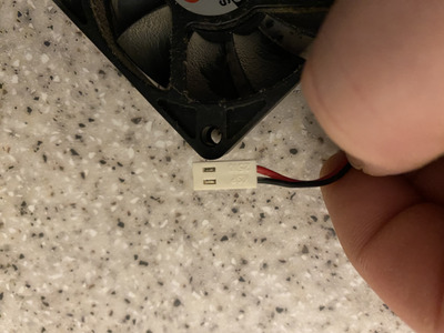

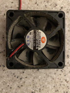

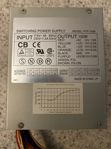

I’m currently in the process of building an old DOS PC. I have an old PSU which works but has a really noisy fan. After reading some suggestions on this site I’ve removed the old PSU fan with a view to replacing it with a new silent one.
I’ve never replaced fans before and while I’m sure it’s straight forward I thought I would seek advice here first before purchasing.
The fan measures 6cm all round and is just slightly over 1.5cm thick. The small white connecter is marked KSP 2510
I’ve attached photos below of the PSU and the fan.
Any help or advice would be greatly appreciated.

To start, you'll need a fan of the same physical size (60x60x15mm). Depending on the fan you buy, if it has the same style two pin connector in the same configuration, that shouldn't be an issue. If it doesn't, you may need to swap the physical connector from the old fan to the new fan.
The other item that can cause issues is current draw. The fan you are replacing is rated at 0.16A. If the replacement fan has too low a current draw, there is a risk it may not spin up properly. I just went through this trying to use a Noctua fan on a 286 computer's PSU. It wouldn't consistently spin up, so I replaced it with a different fan with a higher current draw.
TL/DR: If the specs of the new fan match the specs of the old fan, you should have no problem.

Superred is good fan maker and oldest, rare for oddball name but true. I see them on old vintage equipment too.
Move the red wire and solder directly into 5v. This could work as long as bearing is good.
