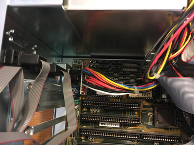

There's a sticker on it that says "MSI: 878945"

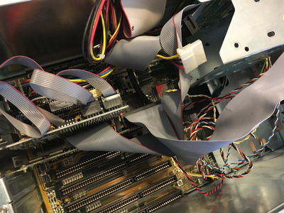

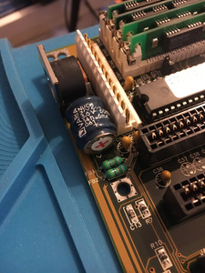

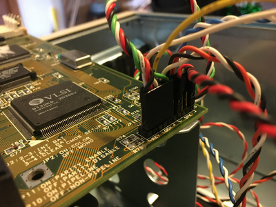

Luckily I have a video from months ago of it, and some pics. Here they are:
https://youtu.be/TzQQ2m1nEV8

Very good condition!
Is that Varta battery original?
The battery is no longer with us. R.I.P.. I took these pics months ago to remember how everything was plugged in because I soldered in a new battery. It now has a cellphone battery pack 😀
See the attached for the BIOS. I verified it 3 times. Seems to be good.
Do you think it's possible to come up with an identity for the board?

Any chance of getting photos of ONLY the mainboard and nothing but the mainboard, front & back.
from the bios code, I'm guessing it's an old MSI board, though not directly listed on theretroweb.
