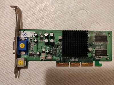

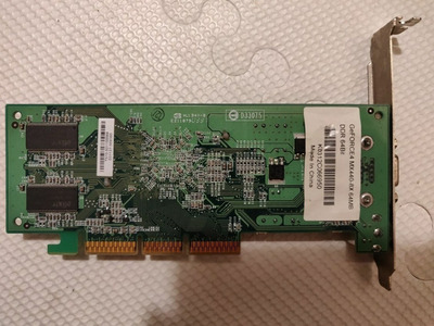

I've just bought NVIDIA GeForce4 MX 440-8x 64mb graphics card. The seller said it was good 10 years ago. I put it in my computer but there is no signal. I tested it in my another PC which is old HP Vectra VL400DT (Pentium 3) it has diffrent AGP port from what I noticed. It works on HP but does not on my computer. Why is that?
My PC is Pentium 4 with Asus P4P800-VM. It has AGP 3.0. The AGP is probably OK, because Matrox G450 card is working there without problems.
Any advices?

Reply 1 of 14, by bogdanpaulb
The AGP slot on the Asus P4P800-VM does not support 3.3v operation (only 0.8v and 1.5v) , the NVIDIA GeForce4 MX 440-8x 64mb , even if is branded 8X it's usualy a 4X card and requiers 3.3V on the AGP slot to work especialy when it's a no name card.
Reply 2 of 14, by pentiumspeed
Either one works well, your card looks like not designed well.

@pentiumspeed: my card is made by sparkle sp7300. card is bad? It should be compatibile according to https://www.playtool.com/pages/agpcompat/agp.html

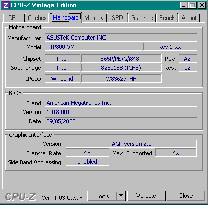

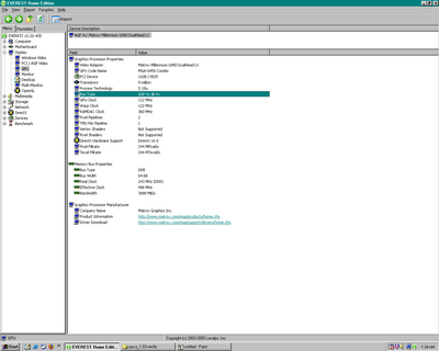

Reply 6 of 14, by informatyk
This is Asus P4P800-VM with Matrox G450. Why it's AGP 2.0 in CPU-Z?

Reply 7 of 14, by bogdanpaulb
It's a bad design implementation of the video card. I've had 2 different video cards (Mx440) with similar design(no name) just different pcb color (they are easy to find because they were very cheap) and both didn't work on AGP 3 motherboards. The ones that pentiumspeed recommended should work/be just fine they are on the higher end.

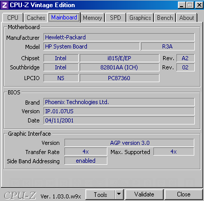

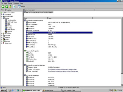

Reply 10 of 14, by informatyk
On HP it is AGP 3.0.
