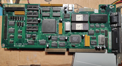

On my first and probably last dump I've been given 2 of those cards:
1.72 MiB
465 views
I've tried to hook it up but as video card won't work (probably because the ram sockets are not populated), it also takes the control of floppy drive and the hard drive.
Is it a all in one card?
Why should I prefer it over an isa vga and a separate super i\o controller?
Reply 1 of 8, by weedeewee
Why? it uses only one ISA slot.
and the VGA does appear to have memory, those 4 chips above the square chip look like memory to me.
now why the vga does not work is anyone's guess. Could be the jumper Envga is in the wrong place.
edit: and if you can, dump the bios eproms.

Reply 2 of 8, by jakethompson1
It looks like it already has 512K of VRAM so it should work. You might try re-seating the two video BIOS chips. It looks like you also have two enable VGA jumpers but no documentation to know how to set it.
As the VGA chip is completely blank, I guess you don't know what kind of video card it is.
I could see preferring it if you're trying to jam one of those really small 386DX-40 boards into a MicroATX case (requires drilling) and only have four slots to work with.

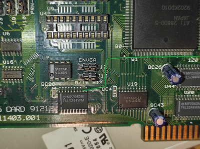

Reply 3 of 8, by Nemo1985
I took the other card, the vga chip is an ATI 28800-5.
There are 2 jumpers with envga, one is labelled j11 while the other is near the lowest memory socket, they both need to be switched to make the vga enabled, it has 512kb of video memory as suggested.
I also took off the jumpers the hdd enable and that made the super i\o card to take back the control for the CF card, while despite I switched side J3 (fdd en) it spins but I get a: error during post.
Here is another picture that shows the jumper description (I noticed they were not visible in the other picture:

Just under the Acer chip there is another jumper which says: HW\SW and it's actually set for SW setting.
Just for the sake of knowledge.
Edit: about the multimeter, tell me where I should use the tips and Ill do it, you know i'm not good with those things 😁
What do you think 8/16 bit jumper is for? Isa bus?
Reply 6 of 8, by Horun
Nemo1985 wrote on 2023-02-24, 22:37:
That being next to the ENVGA probably switches the Vid portion to use 8bit or 16bit ISA, could be handy if you want VGA in a XT.

Reply 7 of 8, by Nemo1985
Good news everyone!
The guess about 8\16 was right, changing the jumper made the card use 8 bit isa.
That's not the end of the story
The hw\sw switch did the trick!
Switching from SW to HW made the card enable or disable the stuff according to the jumpers!
So the plot tickens there was probably a dos software to control the ports?
Any chance to find it?
