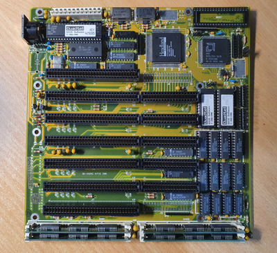

I've been testing all sorts of different RAM in this motherboard and they all come up pretty much the same with errors but then out of dumb luck I didn't install any ram and powered it on and guess what there is 1MB of system RAM on the motherboard, If I put half of the 4 populated slots in i.e. only two sticks in bank 2 it still has 1MB, if I fill all banks (2+3) its still 1MB and removing all RAM still has 1MB, I cant get the RAM sticks to be seen on this motherboard it might be because there is a jumper "JP5" next to bank 2 but I don't have a motherboard manual or jumper settings but I found the motherboard online but its limited see below
https://theretroweb.com/motherboards/s/unknown-ht-12-286
How do I get the RAM to be seen on this motherboard?

Reply 23 of 28, by konc
According to the completely unreliable documentation for this board, in order to exceed 1MB you need to remove the on-board memory and use 1MB SIMMS (in pairs, either 2 or 4).
Also make sure this is not one of those boards that you need to specify the RAM amount in BIOS

Yes, konc is right.
As you can read between the DIL DRAMs and the BIOS ROMs, the banks are named 0 and 1. The SIMM banks also are named 0 and 1.
So I'd recommend too to remove the DIL DRAMs and to continue testing your SIMMs.
Reply 26 of 28, by konc
GabrielKnight123 wrote on 2023-05-08, 14:02:
Thanks for the heads up I'll remove the onboard Ram and continue testing, does anyone have the jumper settings for this board?
At the link you posted from theretroweb.com click "downloads", there is a small pdf.
