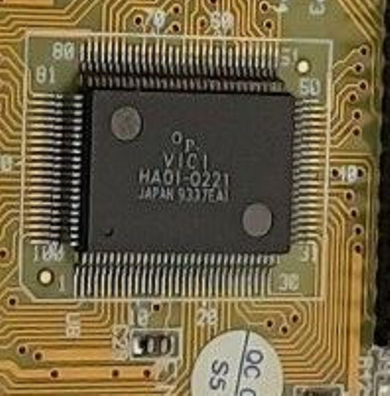

Reply 105 of 262, by douglar
douglar wrote on 2023-04-20, 15:41:
I saw this chip on a VSI-PV1 VLB board for sale on ebay:
Would the manufacturer be VIC and the part number HAOI-0221 ?
After looking at the driver-- I think it VIC is a chip made by Opti
249.82 KiB
1315 views
http://www.vogonsdrivers.com/getfile.php?file … 052&menustate=0
That might have been their first chip. Maybe VIC = "Vesa IDE Controller"
This would be the second via chip from a couple years later:
http://www.bitsavers.org/components/opti/data … ller_199510.pdf

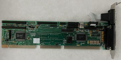

Reply 112 of 262, by TheMobRules
So, I've had this card for a while, model "VLSIO2C3" and unknown brand/manufacturer. It's a VLB controller that uses Goldstar Prime2C for the Multi I/O and an "ADD2" chip for IDE:
445.87 KiB
1208 views
VLSIO2C3
Since there is not much to be found in the Internet about it, here's the jumper settings which I managed to determine by poking around with a multimeter and comparing with an ISA Prime2C card (the IRQ selection jumper block is kind of obvious so I'm only including the jumpers that are not documented on the silkscreen):
    |         1-2           |          2-3
JP1 | PTR is set to LPT1 | PTR is set to LPT2
JP2 | ASYNC1 enabled | ASYNC1 disabled
JP3 | FDC is set to primary | FDC is set to secondary
JP4 | ASYNC2 is set to COM2 | ASYNC2 is set to COM4
JP5 | ASYNC1 is set to COM1 | ASYNC1 is set to COM3
JP6 | FDC enabled | FDC disabled
JP7 | Game port enabled | Game port disabled
JP8 | ASYNC2 enabled | ASYNC2 disabled
JP9 | PTR enabled | PTR disabled
JP38 | ON | OFF
IDE | Enabled | Disabled
NOTE: the game port connector has only 10 pins (?!?!). Not sure if I've ever seen a DB15 to IDC10 breakout cable so I have no idea what the pinout would be.
I also have the drivers, which I am attaching to this post. I tried them a while back but I don't remember how much difference they made, one of these days I will give it another go and post the results here.
    add.zip
    70.13 KiB
    38 downloads
    ADD2 VESA IDE DRIVER
Reply 113 of 262, by mkarcher
TheMobRules wrote on 2023-05-02, 21:26:
Likely that's one of the cost-reduced cards that only support a single joystick (two axes) instead of two joysticks (four axes). You also need a timing capacitor per axis, and it seems the two(!) timing capacitors are C9 and C10 (labelled "2x 103"), which also hints to a single-joystick game port. At the time these controllers were sold, most people that played games already had a sound card with a proper two-joystick game post, so multi-I/O-card vendors often got around with just providing support for a single joystick.
