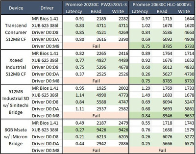

I did a pair of promise controllers and it was one of the most interesting sets so far.
  • Used the Promise VG4 v3.3 driver. https://www.vogonsdrivers.com/getfile.php?fileid=2076
  • I stopped doing the DTC bios, because it was boring, always somewhere between 1%-15% faster than the 1.41 MrBios I have on the board.
  • I tested the MrBIOS settings for 32 bit block mode and it didn't seem to change anything.
  • Speedsys gives some ATA speed info "Selected DMA Transfer Mode : DMA X" when it thinks that DMA mode 0, 1, or 2 was in use, but I'm not sure it is accurate.
  • It was really nice to see XUB shine on the 20230 controller. Seems like a really attractive combo
  • The DMA mode on the 20630 was also very nice, too bad it didn't work with the Jmicron Sata bridge. I tried lower speeds and it didn't help
  • This gives a pretty clear showing how it's not just your storage device, or just your controller, or just your BIOS, but a combination of all 3.

Very nice! Now we know how much faster the 20630 is! Quite a bit indeed... There is also the newer EIDE2300.SYS 3.11 Beta which will work with those chips... Tempted to try that as well?

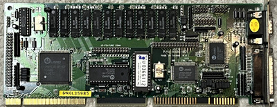

I've been poking around with a UM85C418F based card.
767.03 KiB
349 views
It had a combo VGA/IDE BIOS. The IDE section listed this:
GCW757VL VESA local bus IDE BIOS
TEST ROM FOR UM82C418
Copyright 1992 UMC CO.,LTD
Date:6/8/1993
https://www.vogonsdrivers.com/getfile.php?fileid=2141

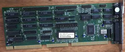

The GCW757VL reference was strange. I searched for it and found that it's a completely different card.
272.35 KiB
353 views
32 bit IDE BIOS Version 1.0
Copyright 19XX GIT CO.,LTD
Date:10/20/1991
One of the error messages in the BIOS needed a proofreader…
Press any key to continue ...  VEAS Card Error !!
https://www.vogonsdrivers.com/getfile.php?fileid=2144
So, maybe the firmware crew for UMC bought the rights to the GCW757VL ROM as a starting point?

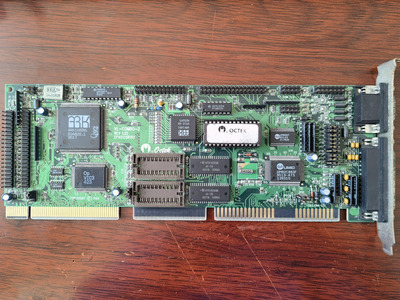

Hello everyone, I have an Octek VL-Combo-2. The IDE control chip on it is OP VIC3 423. Can anyone tell me its information?

That’s an interesting looking board.
I have not been able to get one of those yet, but I suspect that “vic” could be an abbreviation for Via IDE Controller and it might work with this driver: http://vogonsdrivers.com/getfile.php?fileid=2 … menustate=56,55
Edit: Or more likely “Opti VESA IDE Controller” http://vogonsdrivers.com/getfile.php?fileid=2 … menustate=56,55
Edit: Jumpers are here: https://arvutimuuseum.ee/th99/c/M-O/21034.htm
Edit: Drivers and ROMs can be found here: https://web.archive.org/web/19980614085407/ht … ay_Card/COMBO2/
Any chance you could upload the rom? There might be some ide info in it.

That is a graphics chip. The ide and i/o ones are the small 86#.
Their ide performance is disappointing.
