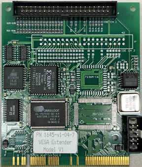

Anyone have any idea what the relationship is between the Cirrus Logic CL-PD7232-QC-AA chip and the XILINX chip on this Vesa extender for this device?

Edit: https://th99.dosreloaded.de/c/U-Z/20796.htm
Jumpers were slightly different
The good folks at TRW set up a separate card here: https://theretroweb.com/expansioncards/s/gsi- … 21-1533-21-09-1
Reply 250 of 262, by BitWrangler
Well that's a 'king puzzle. Seems to be an FPGA as glue logic for the accelerated IDE

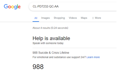

BitWrangler wrote on 2024-04-16, 15:18:
This really is a King Puzzle.
The CL-PD7232 that is on this board has a similar number to the Cirrus Logic CL-PD7220 IDE controller, which is a rebranded Appian ADI/2.
I tried to search for CL-PD7232-QC-AA chip to find out what kind of device it is and google gave me the suicide prevention hotline.

It is a CPLD there, something on the level of a much souped up 20V8 PAL chip. Judging from the connections which are mostly IDE control signals, it perhaps helps with the DMA modes.
Reply 254 of 262, by douglar
The people with the sharp eyes and fine attention to detail at the TheRetroweb determined that it wasn't a "king puzzle" and set it up with it's own entry

Damn, that's one goofy looking VLB controller.

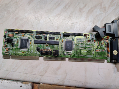

I have this card.
https://theretroweb.com/expansioncards/s/kent … io-v2-003-pdc20
Does the ide interface only work through vlb slot?
Or is there a way to get it working in isa mode?

This card is a "special" card in this regard. It has two IDE connectors, called IDE0 and IDE1. IDE0 only connects to the VL bus, and can not be used if the card is not installed in a VL system. On the other hand, IDE1 is connected to the ISA bus, and perfectly works without being installed in a VL slot. You just need to figure out how to make IDE1 respond to the primary IDE address, and this card will work as full-featured ISA multi-I/O card without being installed in a VL slot. It's possibly, though, that this mode of operation is not supported.
Oftentimes, VL multi-IO cards do not have an ISA-connected IDE interface at all, and those cards can not be used as IDE interface cards at all if they are not installed in an VL slot. I did already use a VL controller card in non-VL systems because the VL multi-I/O card had a more modern multi-I/O chip than the ISA I/O cards I had at hand, so I got serial ports with FIFO and a parallel port with ECP/EPP capability. This approach worked fine both in a PCI-based system (using onboard IDE) as well as an XT system (with its RLL hard drive). In both applications, the IDE part of the card was of no use for me, so I didn't care about it being invisible if the card is not installed in a VL slot.
