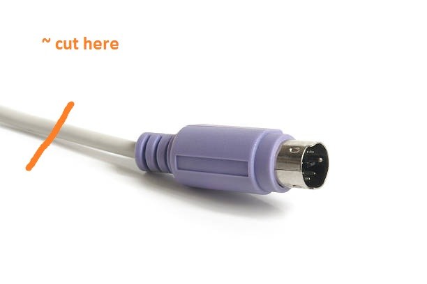

Reply 47 of 90, by bogdanpaulb
Your spare keyboard is ps2? If so i will make a diagram for you. Just measure that pin when the computer is on so we can be sure. Imagine that if you find hard to solder 4 wires on that mini din plug, removing something like this: https://www.ebay.com.au/itm/394052954656 from the motherboard is way harder and i don't think the female mini din 7 connector is pin compatible with the female mini din 6 connector, so more work. Also when you cut the cable with the old connector from the keyboard, be sure to leave about 2cm/1inch of wire on the connector so i can be able to understand the color scheme for the pin out (it's not always standard and can be different sometimes).

Reply 48 of 90, by biessea
bogdanpaulb wrote on 2023-05-03, 23:48:
Perfect I understood.

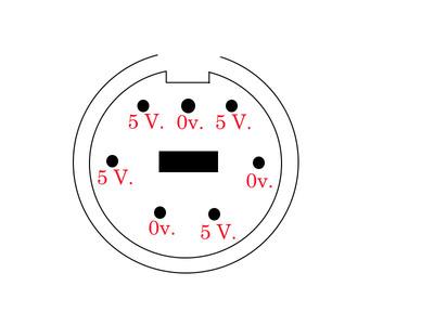

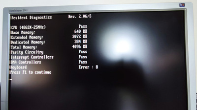

Reply 50 of 90, by biessea
Ok, I just measured the voltages with the computer ON and this is the results;
before I signed TWO Grounds, when I think it's only one, the pin on the middle right.
I put the image of what I measured. Hope the situation is now more clear.
    104.72 KiB
    344 views
    Stuck on that keyboard error.
    36.55 KiB
    344 views
    connector 7 mini din voltages with computer ON
Computer lover since 1992.

Reply 51 of 90, by bogdanpaulb
biessea wrote on 2023-05-04, 09:45:
This part isn't clear for me. […]
bogdanpaulb wrote on 2023-05-03, 17:30:
Now you can try to buy a male mini din 7 connector: https://www.ebay.it/itm/263066804942?hash=ite … %3ABFBMuoaMqvxh and female din 5 connector or female mini din 6 connector (depending on the keyboard you want to use): https://www.ebay.it/itm/393393451469?hash=ite … ABk9SR-q-3en8YQ , get some 4 wire cable and make an adapter.
This suggestion was if only I don't want to cut the keyboard cable isn't it?
And can you explain this more? I really cannot get into it.
That re-measurement confirms this:
mkarcher wrote on 2023-05-03, 17:09:
I think this is the correct pinout instead: […]
bogdanpaulb wrote on 2023-05-03, 16:57:
The if the measurements from first page are correct (please make sure again), this should be the pinout.
The "GROUND" assignment of the +5V pin in the first post happened, because the internal resistance / leakage current on the unpowered 5V rail is low enough to make the meter beep in continuity test mode. The 38 Ohm measurement clearly shows that this pin is not ground. 30-70 ohms is a common measured value on +5V on AT main boards.
Yes, that was a 'parts' list to build an adapter similar to this(not identical): https://www.microconnectors.com/ps-2-to-at-ke … -to-din-5-male/ and keep your keyboard without any modifications. The advantage of an adapter like that is that it will allow you in the future to replace the keyboard easily if you need it. Just replacing the mini din male connector on the keyboard cable will work also, but if something happens to that keyboard, when you replace it you will have to replace the connector again.
For just replacing the connector on the keyboard cable you will need only this: https://www.ebay.it/itm/263066804942?hash=ite … %3ABFBMuoaMqvxh , if you what to build a ps2 adapter you will need 1 male mini din 7 connector, 1 female mini din 6 connector: https://www.ebay.it/itm/263066804942?hash=ite … %3ABFBMuoaMqvxh and a piece o cable with 4 wires internally (you can salvage that from a usb data cable or something similar).
Let me know on what approach you decide.

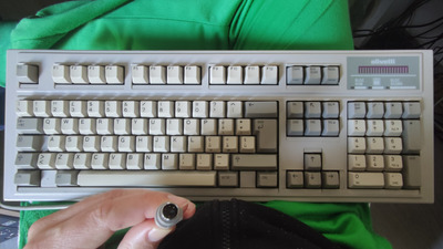

Reply 55 of 90, by biessea
Here is my dear Olivetti keyboard, bought from a giveaway of an italian office of energy delivering (ENEL).
The exact model is ANK 27-102N.
As you can see the PS/2 connector has only 4 poles. I understood now why you told me that only 4 wires is needed for that operation.
Ps: I just bought two connector from a pair, two couple. Nice.
    616.33 KiB
    296 views
    Olivetti Keyboard ANK 27-102N
