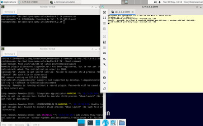

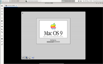

Initial testing with OS 9.2.2 seems to work fine on Proxmox 7.4-3 (after restoring the '/usr/share/kvm/openbios-ppc' file that the pve-qemu build does not provide by default).

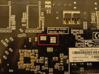

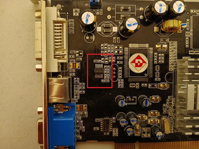

Next step is testing a cross-flashed ATI Radeon 9250 128MB PCI (VROM pulled from The Mac Elite's site, along with resistor mod diagrams for PC/MAC support):
http://themacelite.wikidot.com/9250-trick
http://campahunta.free.fr/Downloads/ROMs/ati_ … pciagp_full.zip
I have also attached pics of my modded 9250 for reference (EEPROM swapped from a 64KB 25P05VP -> 128KB 25P10VP, above firmware flashed with external programmer, and resistors removed and bridged).
NOTE: I have a 256MB 9250 also, but it's in use in my G3 currently - so the 128MB (pictured) will be the testing GPU for now.
Here's my QEMU startup script for reference (sets up the VM, starts it and then automatically launches the VNC session):
#!/bin/bash
qemu-system-ppc \
-L pc-bios \
-M mac99,via=pmu \
-m 512 \
-boot d \
-drive file=MacOS9.2.iso,format=raw,media=cdrom \
-drive file=MacOS9.2.img,format=raw,media=disk & remmina -c vnc://127.0.0.1:5900
