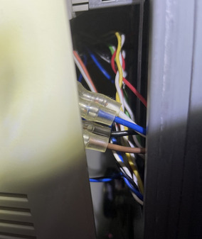

i have been working on a 166mhz mmx computer. Its in a nice old 1995 era mid tower (one of the old ones with turbo btn and a digital number display). Been retro brighting the plastic and painted the metal very carefully. Will post images when done.

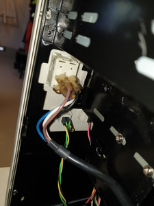

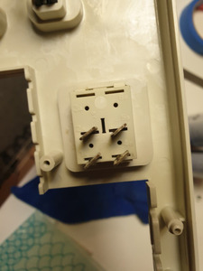

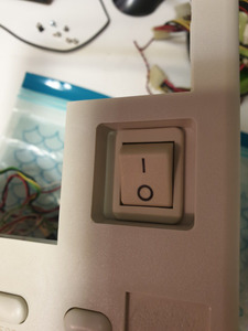

I took lots of images while disassembling it but I must have forgotten the Power Button cables as I cannot find these. Its one of these old power buttons (see images)
I got a black, white, blue and brown cable from the AT power supply (it was connected before I disassembled everything) - Which color goes where on the
1A, 2A, 4B and 5b connectors?
Reply 1 of 17, by weedeewee
grab your multimeter and check which wires attach to the power inlet on the psu.
It could be blue & brown. better measure to be sure, or open up the supply and visually determine which is which.
Then measure the switch. depending on the state of the switch on or off, one pin should conduct to another ,likely 1A to 2A and 4B to 5B.
The live wires, ie the wires coming from the power inlet on the psu should go to 1A & 4B, the other wires should go to 2A & 5B
Do not ask Why !
Reply 3 of 17, by claesbas
Woops, this setting blew the fuse in my garage. I hope nothing got damaged.
84.22 KiB

Reply 5 of 17, by kixs
https://www.informit.com/articles/article.asp … =31105&seqNum=4
As long as the blue and brown wires are on the one set of tabs and the black and white leads are on the other, the switch and supply will work properly. If you incorrectly mix the leads, you will likely blow the circuit breaker for the wall socket because mixing them can create a direct short circuit.

This is correct. Thanks a lot!

When I saw the photo I immediatly wondered why would he post such a photo where nothing is clear and just some colored wires stick out.

Yeah, was a bit of a diffuse photo!
I think I am all good here though - the switch looks good and everything seems just fine now when correctly connected. The wires and the switch casing+metal there are quite heavy duty stuff. Its not like in modern PCs.
