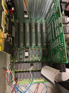

today i recieved a new "black box" Desktop System which i bouhgt on ebay Kleinanzeigen in germany with a little hope that it will be a 286 System.
But today it seems to be my lucky day bacause when i switched the system i recorgnized that it is an old XT System with an Siemens 8088 Processor.

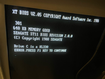

At the post screen it counts the RAM up to 640K and shows me a message from the build in Seagate MFM Controller that the Kaolak MFM Drive iss configured. But here the system stops with an error and want the F1 Key to move on.
Unfortunally the system don't recorgnized any of my old DIN Keyboards. i cannot press the F1 Key, nor the numlock, capsloc LED can be switched on.

The Mainboard seems to running an XT BIOS from AWARD.

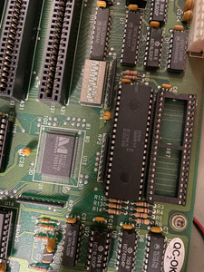

When i take a closer look it seems that there is an IC with the Label "ASIC" missing.
The Mainboard is equiped with an Keylock Option wich, said the manual, must be shorted when the keylock should be dissbled. I allready tryed to short the Keylock with an jumper, but this changes nothing.
Is this IC maybee the reason why the keyboard is not usable ?

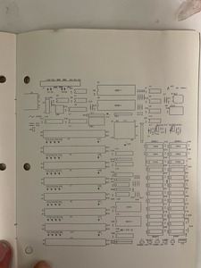

unfortunally i find no further infos to the mainboard the manual said the modell of the mainboard is BS-111

Reply 1 of 14, by Deksor
XT computers use a different keyboard protocol. You can't use an AT-PS/2 keyboard on an XT without an adapter.
Some old AT keyboards have a switch somewhere to switch between AT and XT, but they're not very common

Reply 6 of 14, by kawe-dus
i can't belive it, but i found an cherry g81 Keyboard with an AT/PC Switch in my basement. Now i am able to boot the system from the MFM Drive.
unfortunally i'am not able to use the buildIn 5 1/4" and 3,5" drive. the LED on the Devices are going on when i access the drives, but they cant read or write any data.

Reply 8 of 14, by Rwolf
What I recall, the missing BASIC ROM should not be a problem; IBM had a BASIC interpreter that was partly residing in ROM and partly in an executable on disk, and if you had an application in BASIC it used both (I guess it was split to prevent copying of just the executable to a clone PC).
However alternate BASIC interpreters, like GWBASIC were developed that did not use the split functionality, and those were often installed on clone PC:s instead of the IBM version that also needed the ROM.
