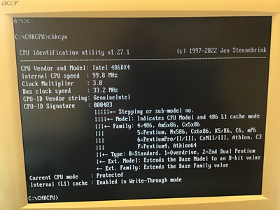

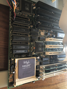

I swapped the AMD 486DX4-100 from my PC for an Intel CPU. Also a DX4-100 (don‘t ask me why).
Fortunately I was able to download a manual somewhere so I checked the jumpers.
The PC was running with the amd without problems so I thought I could just swap the cpu and done.
Well, no way: I had to change a lot of jumpers which I find a bit odd. Both CPU‘s are 3.45V and 3 x33?
Am I missing something here?
Maybe someone is familiar with the mainboard?
Specs:
Gemlight GMB-486SPC V0 ( manual is for V1)
Intel 486DX4-100 SK-096

To answer my own question, I powered on the PC . What could go wrong, right?
CPU shows up as a DX4 S with 100MHz but now I got a floppydrive error and some error from the SB CT2230.

Reply 4 of 11, by Chkcpu
Hi Kouwes,
Okay, the Intel DX4-100 works. From the &EW marking and SK096 number on the CPU, I see that it is a rare DX4 with L1 cache Write-Back support. Great!
This explains the floppy drive and soundcard errors because they both use DMA which can create L1 cache coherency problems when the CPU is in L1 cache WB mode. So I fully agree with jakethompson1’s remark.
The cause of these problems is usually incorrect jumper settings or lack of BIOS support or both.
To help you find the cause, I have some questions:
- You write that the board is a GMB-486SPC V0, but could it be a GMB-486SPS V0?
- What is you BIOS version and ID-string?
- How are your CPU type jumpers JP4 up to JP17 set? Looking at the 486sps103 manual I would start with the settings at table 1G.
- What was you previous Am486 CPU type, NV8T or SV8B?
Greetings, Jan

Reply 5 of 11, by Kouwes
Thanks for the replies!
Previous CPU was an Am NV8T. Someone wrote that on it, the top side has a heatsink glued on. I tried to remove it but that’s hopeless and I don’t want to damage the CPU.
The board really is a 486-SPC V0 and the jumpers are set as shown in table 1C from the SPC manual, I double-checked they are set correctly.
Table 1G are the settings for 486SX in this manual.
I took the board out of the case and as soon as it’s running again I’ll add the BIOS version.
But maybe a BIOS reset will do the trick.
I also have a 486DX50 which I could use…
Reply 6 of 11, by Disruptor
Oh!
Since an Am486 DX4 (N)V8T behaves like a 3,45 Volt DX2 with L1 cache in write through mode, you need a different jumper setting for a write back enabled DX4 like the Intel &EW.

I just loaded the BIOS defaults and now it boots to DOS without errors, but I still need to install a heatsink with thermal adhesive.

Reply 8 of 11, by ediflorianUS
I just disabled everything in the bios after the jumper settings (that took days to figure out) , then re-enabled one-by one , check out my 486 project.
My 80486-S i66 Project
Reply 9 of 11, by Kouwes
Your board looks exactly the same! Until you take a closer look but the layout is about the same.

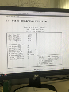

I haven’t had time to check my BIOS settings but will do so after work.
There‘s a PCI section I found in the manual.
I also found out this board doesn’t support 50MHz CPU clock so that 486DX50 goes back in storage.
