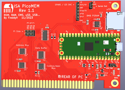

I finished the PicoMEM 1.1 Board, supposed to correct all the known HW Problems.
- USB Power Fixed
- uSD/PSRAM routing improved
- Added one IRQ (IRQ5)
- Correct a Startup problem with PC1512 and other
- QWiiC connector added
402.23 KiB
1451 views
I will produce 20 Boards as I am quite confident and to not spend too much if it fail anyway.
