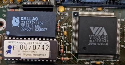

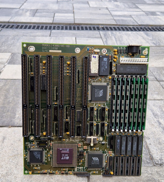

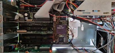

After I've recently found some of my old PCs while clearing out the attic I came across my very own first PC: An AMD 386 DX 40 on a 4386-VC-HD board with 8MB RAM, a "HighScreen Blaster 3.0" (Soundblaster 2.0 clone based on CPS' Soundblaster 2.5), 120MB Connor HDD and a Trident TVGA 9000B with a whopping 512KB VRAM.
I even got it to post, albeit the dreaded Dallas RTC reared its ugly head and greeted me with a CMOS battery error. I then opened the case and to my great surprise realised that not only did my late father who used it after I got a new PC upgrade it with a 387 FPU but the board could also house a 486 DX/2 66 instead of an FPU:

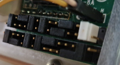

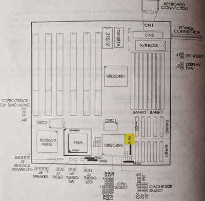

According to the manual (thank got I kept it) if you want to install a 486 DX/2 66 you'd have to switch two resistors, swap the oscillator to a 33MHz model (currently it has a 80MHz model installed due to the 386 DX 40) and set the jumpers accordingly:

Apart from the switching resistors, setting jumpers and swapping the oscillator do I need to do anything else before upgrading the board? For instance when I looked at the BIOS chip on the mainboard I got worried since it says "386DX". Does that mean I also need a new BIOS for a potential 486 DX/2 upgrade? I've found several pictures and a video by VSwitchZero that show that there are indeed BIOS chips that are labeled "486DX". See his video here (he also has a 386 installed): https://youtu.be/MV8nkl1Cjw0. Here's a picture of my BIOS chip:

Reply 1 of 8, by jesolo
I have the same motherboard and, to get it to POST, I had to replace the Dallas RTC (fortunately, I was able to secure a "new old stock" Dallas RTC that still worked fine).
This motherboard is very similar to the OPTI495 chipset-based range of "hybrid" motherboards that could also accept both 386 or 486 (5v) CPU's. However, most OPTI boards I've come across do not require a user to swop out either the crystal oscillator or resistors.
Regarding the BIOS ROM chip - it's perfectly fine for it to display "386DX" since it's (by default) a 386 motherboard that can upgrade to a 486 CPU. The BIOS ROM itself does support both 386 & 486 (5v) CPU's - if you dump the BIOS ROM contents with a utility like Navratil System Information (NSSI) and read the contents of the BIOS ROM (with an ASCII editor), then you'll see the list of CPU's supported.
No, you cannot flash this BIOS ROM chip (at least, not directly in the motherboard) - it is an EPROM chip and to reprogram it, you need to physically remove the chip, erase the contents in an EPROM UV eraser and then write the new contents to the chip with an E(E)PROM programmer. I wouldn't recommend this.
If you do find a more up to date BIOS ROM version, rather use a drop-in replacement EEPROM chip (like the W27C512).
Check out this link (and the downloads section): https://theretroweb.com/motherboards/s/fic-4386-vc-hd
You will definitely benefit by upgrading the CPU from a 386DX 40 MHz to a 486DX2 66 MHz which will the make for a great late 80's to early 90's DOS based system.
Just be aware that, once you go above a 486 DX 33 MHz, you will be slightly bottlenecked by the ISA bus (in terms of your graphics card throughput), particularly in games like Doom. Unfortunately, this motherboard does not have any VESA Local Bus slots that you can benefit from.
PS: If have some time, scan in the entire manual and share it with the community that houses the information on the Retroweb (there is a Vogons page as well where you can make contributions).

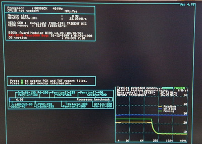

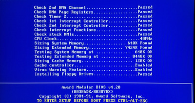

Strange that yours didn't post with a drained battery alone. Here's my post screen:
1.12 MiB
433 views
I even got mine to boot by removing the HDD and booting from FDD. It wouldn't save the HDD parameters and without HDD Auto Detect no IDE HDD would ever work without a good battery. Even though the FDD defaulted to a 5.25 1.2 MB drive in BIOS I could use a 1.44MB 3.5 disc, it just wouldn't read past 1.2MB. Of course I had to do a bit of benchmarking (a bit strange that writing is faster and doesn't drop off like reading after the cache is exhausted)

Yes, what you've described are the symptoms I also experienced - it essentially rendered the PC useless until the battery was replaced.

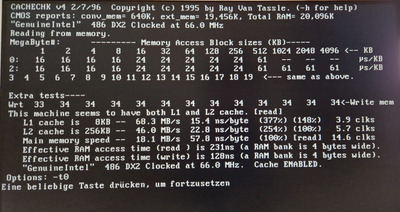

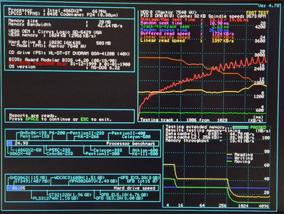

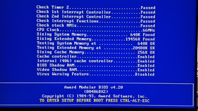

Just a quick heads-up if someone has the same board and wants to upgrade. A fellow retro fan swapped the Dallas IC with a Necroware battery-replacement and even upgraded the BIOS EPROM from the installed 1.10K to 1.15k (although the 1.10K should also support a 486 without a problem). After this I was ready to try the upgrade and I'm happy to report I could successfully install a 486DX2-66 on the 4386-VC-HD motherboard, disabling the onboard 386DX-40. I had tried last week but the PC wouldn't post. Did the same procedure once more yesterday - set jumpers, swapped the two resistors (to RN10 and to RN51), replaced the onboard 80MHz quartz oscillator with a 33MHz one, removed the iit 387c FPU that my father had installed 30 years ago and placed the 486 into the socket. Only this time I used more force and I could feel it sliding into place, which I didn't last time. Lo and behold, I was greeted with a glorious post screen

An AMD and Intel CPU together on the same board - could this be love?

Speedsys made a massive jump from 6.49 to 24.93, cache throughput also increased by 2MByte/s
993.02 KiB
170 views
Cache performance seems to be influenced by faster latencies - went down from 37.6ns/byte to 22.8ns/byte
